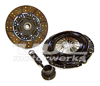

                      • MR 325
                        • 37834
                        There is also a stock single mass conversion kit with clutch available. I know it's available from at least two of our suppliers at work. Definitely not cheap though.

                            • MR 325
                              • 37834
                              Originally posted by rThor432
                              ^^Probably around a grand for the whole kit? Our suppliers have a similar kit for the M42 with a 19lb. steel flywheel and Sachs components that costs $750.
                              About $750-$800 I think. That includes single mass flywheel, disc, pressure plate and TOB.
