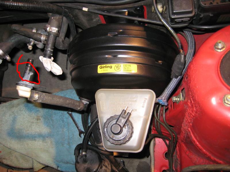

              i had a vacuum leak at the one of the nipples on the brake check valve that caused my idle problem.
              it doesnt looked plugged basing on the pic of your booster.
              check it out....
