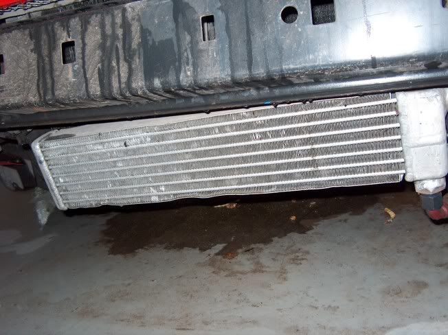

                Does the E28 M5 cooler count as non OEM? It mounts easily, though not entirely horizontal.
                Huge pic...
                I haven't installed any of the lines yet, but you need two M22x1.5 female to AN -10 adapters, then all the hose and fittings, then the kit from any one of the turner/bimmerworld places to use AN fittings with the Euro oil filter housing. Tons of other ways to do it though - you can get fittings with the correct M22x1.5 thread, but I want to go with the adapter.
