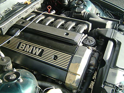

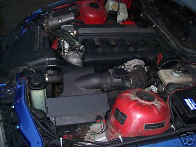

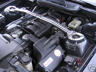

                          Here are some pics of euro 325i's from ebay.de. What do you guys think about the position of the engine relative to the radiator? I think the e36 radiator sits a good 3-4 inches further forward, which might cause some issues.

                            I sent he owner of this guy on bimmerforums a PM asking what hoses he used. His look perfect!
