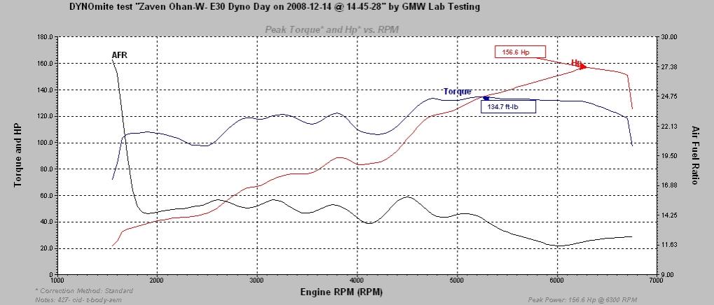

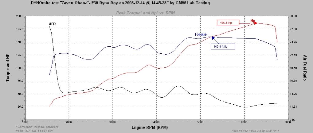

          one thing that i did notice from my dyno @ rms was that i got 2 graphs the wheel and crank hp... 187 crank and thats with headers/s50 cams and ebay software.... im running a m50 and someone tell me what the stock hp is on a m50 agian? i forgot... 189 right.
              Looks like the maf, injectors and a tune will do a lot for you to Zaven! You afrs are worse then mine, and you're running even richer up top then me.

                ive done it and im still lean spiking.... im gunna need a fuel pump.. go walbro!

                  it does look like a better tune could get you some more, it's pig rich up top. The rest of the AFRs aren't too bad, it probably needs mostly ignition tuning (and subsequent fuel retuning).
                  so much for 200whp M50NV's with bolt ons. :p
