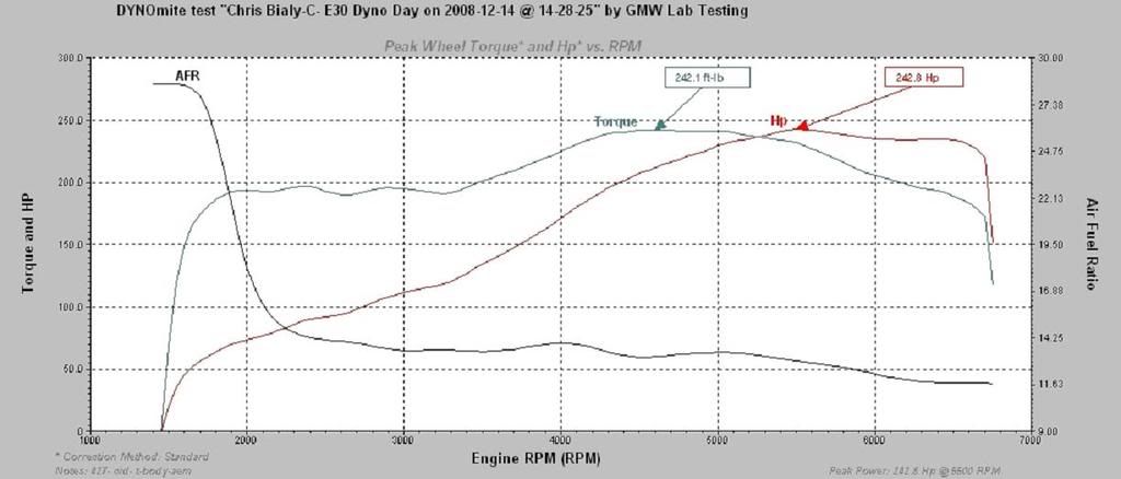

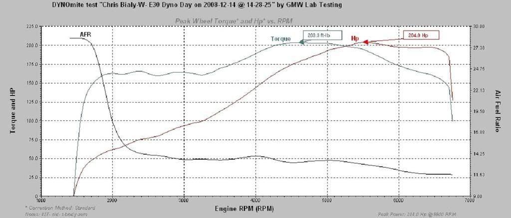

    Dyno graphs from RMS...interesting results
    Motor: '98 OBD1 s52 w/ 68k miles
    Mods: OBD1 manifold, ebay headers, 540 hfm, 24# injectors, ltw flywheel (13lb), 2.5 exhaust, and Turner chip for mods listed.
    After looking at the BFC dyno graphs, I see that my tune runs pretty rich up top, robbing me of peak power after 5000 rpm. I will be getting some cams reground to Schrick specs and send for the $100 tune upgrade from Turner.
    Osh said that my car had 20-25whp left in it from a better tune, but i will see how the tune is for the cams when I get it. Any ideas other then the tune?
    Crank Graph: 242.8 hp/242.1 tq
    Wheel Graph: 204 whp/ 203.2 wtq

    thats depressing, yet promising.
    If "your car embarrasses the rich folk" with only 200 at the wheels, I can't imagine/wait to see what it feels like when yours is running properly (and when mine is finally done!)

      Ya I was pretty shocked, but it made sense. I don't make much power after 5k so I always shift by 6k. I wish Turner could lean the chip out for me and smooth out my AFRs.

                  Yikes, those numbers seem pretty depressing for an OBD-I S52.
                  Anxious to see what your numbers are with a proper tune!

                    What kind of dyno? Its fairly useless to compare peak #'s unless they were done on the same dyno under similar conditions.
                    Oh, and please don't have your car "tooned" by RMS.
                      Why not? Osh has been working on s50/2 motors for years now, and did a great job retuning E30 Fiend's Mark D Chip! He was able top get another 10whp on top of the Mark D tune. And yes i heard about the blown motors on the m5 and the m3.
                        Ya I was hoping for atleast 225whp. :(
                        But it has quite a bit of potential with how rich it's running up top. :D
                              We run a clayton dyno calibrated to mustang dyno specs.
                              By "tooned" you mean...?
