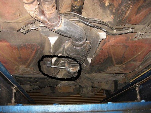

                        Where did you get that exhaust hangar? Did the exhaust shop source that for you?

                            I just got the hanger from the exhaust shop then I had to bolt it up and weld it on there. Things were pretty solid before but this provides good support for the middle parts.
