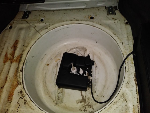

    Look at the e36 locations for smog stuff, they want to see all those pieces in pretty much the same location as the donor car. 16 pin OBD2 connector as well.
    Save yourself the extra trips to the store and just get the big jar of vaseline.
    Mine

                  Mine
                  Click image for larger version  Name:	49050020302_aa0d48d471_z.jpg Views:	75 Size:	66.0 KB ID:	9884660
                  My buddy suggested doing a full tear down and swapping the body harness from the 99 roadster over but I feel that may be over kill... I'm going to pull the smog stuff first before we pull the motor so I can map out the swap harness connector wires. Not a lot of information on working the 16 pin connector in to the stock e30 harness though ha.
                  • bradmer
                    • May 2016
                    • 362
                    I agree with your buddy, get as much as you can from the donor car. Always nice to have the correct color coded wires.
