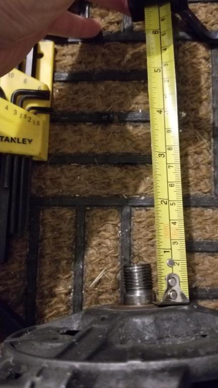

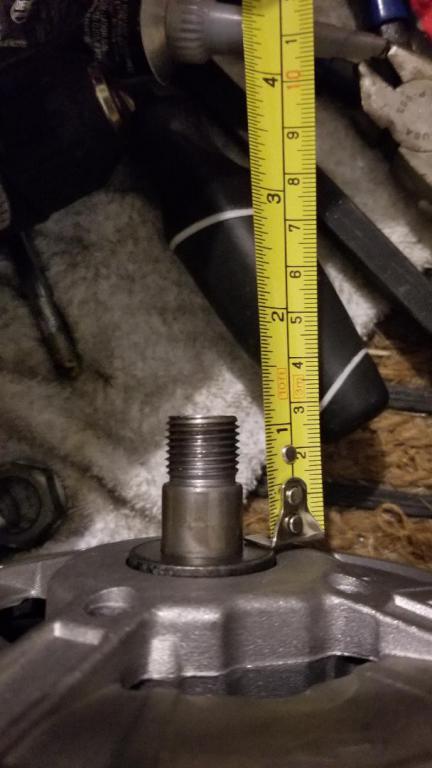

          So I'm having a problem with the alternator I ordered. The shaft the pulley installs onto is about a half an inch longer than on the old alternator, with most of it not being threaded. When I tighten the bolt all the way down, the pulley is still spinning. Did I buy the wrong one?

            Generic observation: the shaft on the left looks like it's designed for a stamped- steel v- belt pulley,
            and the one on the right for a multi- ribbed 'serpentine' cast pulley.
            If the shaft sticking out doesn't hit anything, you can simply put a spacer on the front of the pulley
            to clamp your sheet metal pulley. If there's no room, then further part number research is needed.
