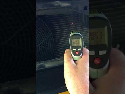

          It's a pusher fan. I don't remember the brand of it.
          I did have an issue with the cooling system 2 years ago, but that was not fan-related. You can see the setup in the video I made back then.
          (Flushing the engine solved that by the way)
