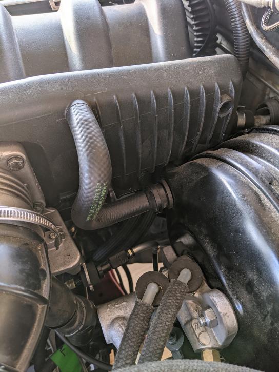

    How did you guys connect the vacuum line from the booster to the intake manifold?
    I used the one-way check valve that came with the booster, then used this and cut it a little at each end.
      Could you by chance post a picture? Mine just came with the semi rigid hose and I'm not sure where there is a check valve at all. Thanks for the parts link Sent from my SM-G960U using Tapatalk

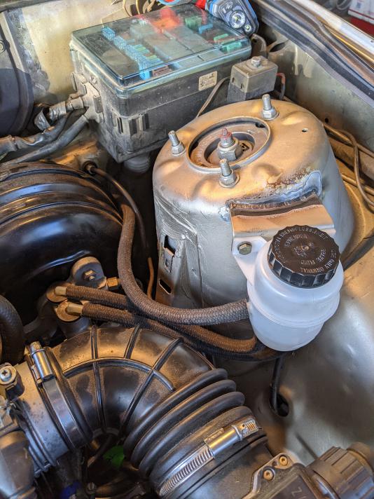

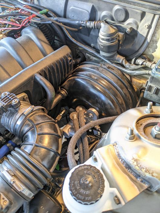

          #34
          Thanks so much for the pictures. I didn't want to see that we have to relocate the reservoir but after test fitting the throttle body I think we have no choice. It's either that or taking out the booster and going with a different booster and hopefully don't have that issue. F..k I feel like the car is fighting us every step of the way Sent from my SM-G960U using Tapatalk

            #35
            The X3 booster fits and works so well that it is worth relocating the reservoir. I like Chilezen's welded bracket but you can also bolt up something to the strut tower in a similar fashion.
            All those 2002 parts for the remote setup are available from ATE in the aftermarket.
