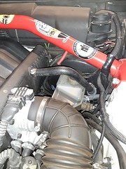

    I'm in the process of installing an X3 Vacuum Brake Booster into my M50 swapped 1988 Coupe. Does anyone know what adapter fittings I need for the brake lines? I bought M10 to M12 adapters, but they only fit into the X30 Master Cylinder. The lines won't fit into the M10 side.

      As you can see the M12 side is a taper fit and M10 side is also tapered for the e30 bubble flare brake line. This is very important because threads don't seal the system from leaks, the taper ends do.

            Thanks, that's just what I needed. Most of the adapter fittings available don't have that bubble flair end on BOTH sides.
