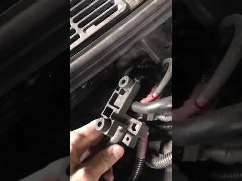

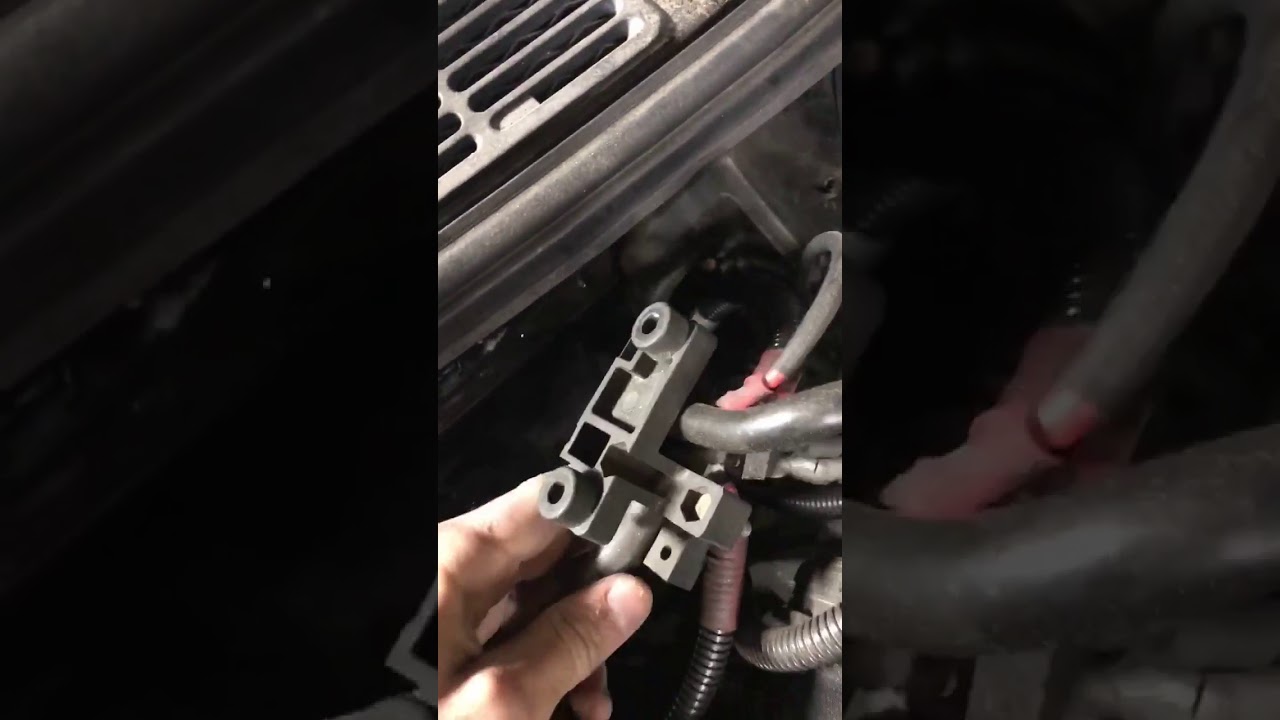

    4. There is one ground that is not hooked up (pictures attached below), let me quickly explain why:
    I have previously attached that black ground to chassis and it sparked, so it must be a negative coming from the battery side.
    The reason I didn't attach it back is because I really don't know where does it go!
    This short video I took will show you which cable I am talking about: https://youtu.be/AiQeSLXx1Xs
    I taped the cable in red color tape so it wouldn't touch the chassis by mistake and start a fire.

    That cable looks to be the original positive +12V wire that supplies power to the starter on the M20. You must have run another power wire to your S52 starter?
    That cable junction you have in your hands (in the video) is the +12V junction that is supplied by the battery in the trunk - follow the big black wire that runs through the firewall to the truck. If you have hooked up grounds to this junction block you will have all sorts of issues....

        The black cable used to be the m20 starter/alternator junction. Since the PO tied into the stock e30 battery block, it's just a loose end. Can attach it to the starter on the outside large terminal if you don't want to cut it out.
