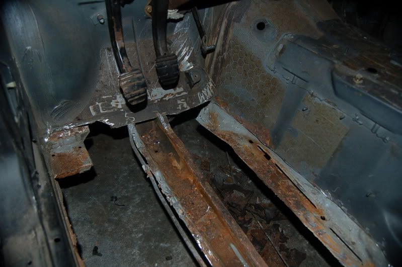

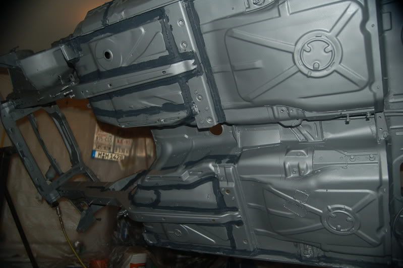

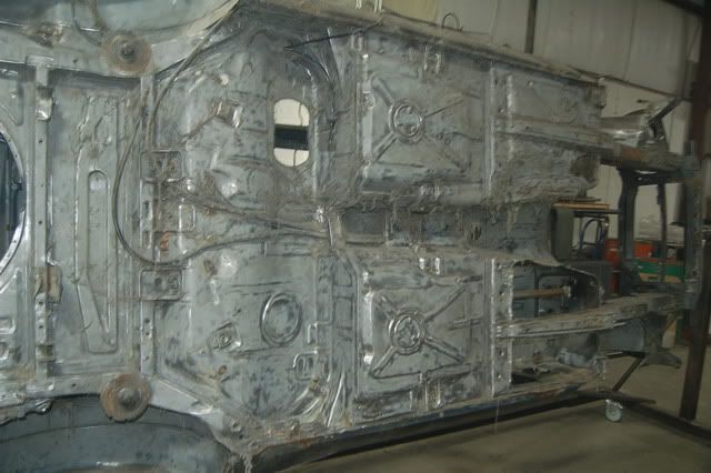

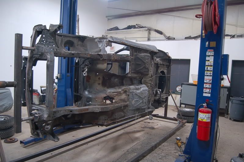

                    Originally posted by Jason89i View Post
                    this is the pinkie car..... code named (from my brother in law) "rose."
                    its been 16months so far.....
                    as you can see, it has been a LOT of work. without my buddy john, it would still be rusting on my garage floor. But this is the pinkie car.
                    Seeing these pictures makes me shiver! I can only guess the amount of time/labor involved
                    Good job!

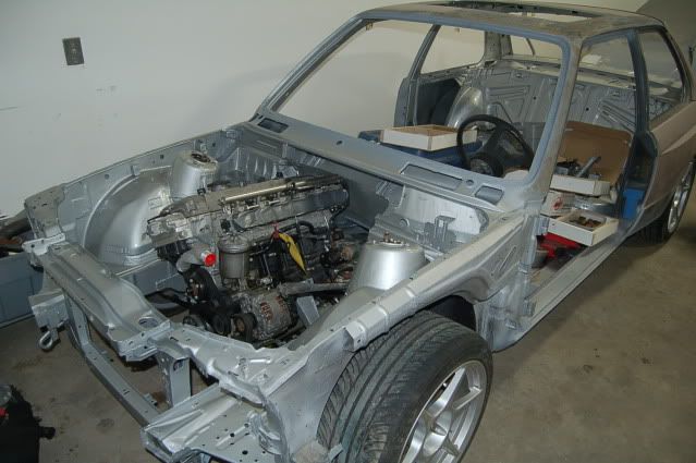

                      I have been following your thread on S14, do you know what the Front Rear balance is with the engine moved back 4 inches? How about total weight? I would love to see how this beast compares to something like John's 2.7L S14 in Germany. I am guessing you came out on top cost wise, as we all know S14 builds are not cheap...
                        #41
                        dont have weight numbers yet. it will be interesting to compare with some of the other cars ive driven. http://r3vlimited.com/board/showthread.php?t=90486
                        cheers, jason
                            cheers, jason
                            I have read that thread a few times, I have a 91 318is with a blown M42 that I am trying to figure out to do with, Thanks for doing the weight comparisons, seems like you could get an aluminum block M50 to have close to the same Front Rear balance with a carbon fiber hood and maybe some cheap seats. I am leery with rumors of the headstuds stripping out with some of those blocks though.
                            Like I said, love the swap and can't wait to hear your impressions when you get it out on the track...
