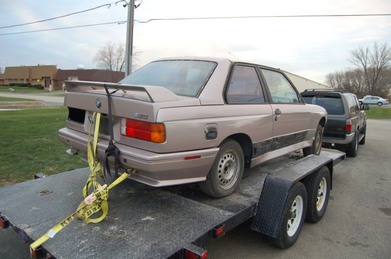

                          this is the pinkie car..... code named (from my brother in law) "rose."
                          its been 16months so far.....
                          as you can see, it has been a LOT of work. without my buddy john, it would still be rusting on my garage floor. But this is the pinkie car.

                            Originally posted by Jason89i
                            hey guys. been awhile. i havent posted here much lately, but thought you might be interested.
                            s54 into an e30 m3 (that was a basket case when i started. )
                            engine moved back (4.5" ) after cutting firewall.
                            dta engine management from alex at ABL Originals.
                            should be a fun H.P.D.E. car.
                            anyways, pics say a thousand words.....
