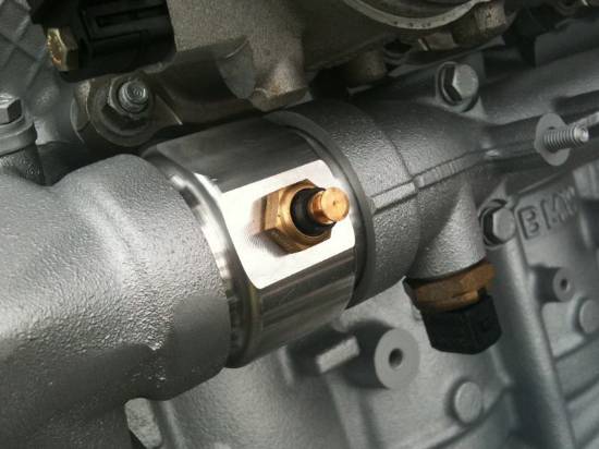

    Known issue - the coolant temp sensor (e30 one) isn't grounded, so the dash isn't displaying the temp. I painted the block and the motor mount arms, so there isn't a metal to metal connection behind them. I ran a ground wire from chassis to mount, and then another one from that point to the block. The only CEL present is for the O2 heater circuit. This leads me to believe the car isn't going into closed loop, but I don't know why.

                  The e30 coolant sensor is the only one that has only a single wire going to it for grounding I believe. Will get the code definitions...

                    It sounds like you're on the right track. For the coolant temp sensor on mine I just tapped the top of the thermostat housing. Use a 1/2 inch drill bit to make the hole then tap it with a 14x1.5mm tap (Snap-on has them). It's not thick metal so just be careful.

                      I'm using this
                      Because the E30 sensor doesn't have a wire ground, and the pipe piece is insulated on both sides via the rubber o-rings, the sensor doesn't get grounded. For anyone that uses this, they should weld on a small stud to attach a ground wire.
                      • nrubenstein
                        • 3148
                        For the moment, wrap a wire around and run it to ground? It's half assed, but it's a quick solution for testing.

                          Thats what I did ;) And it works. I will fix it properly whenever I decide to flush the system sometime. That time is not now lol.
