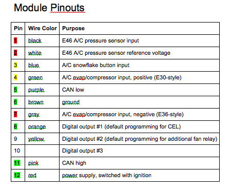

                        • R3Z3N
                          • Jan 2011
                          • 3056
                          #117
                          Which of the pinouts plugs into the AC Compressor's one wire?
                          See attached image. Yellow I know I need, Green is done, Red I do not use. Also can you provide an example for the AC Relay and Fan relay needed for E30? Thanks!

                            Here is a modified version of the E36 ETM that shows how to connect a relay to the MSS54 DME. You can use a standard Bosch relay or E36 A/C compressor relay wired like this:

                              #119
                              So, my car no longer has a C136, however I found the wire was direct to my S52 ECU, which the C136 is now gone for the S54 ECU. Connect: Red/Black pin 1 from my missing C136 to pin 4 of the CAN Converter box? Pin 2 was into the S52 ECU, but now no longer if I am correct.
                              Now, here I am confused from this image. Does that same red/black Pin 1 C136 connect straight to compressor clutch, along with the relay from the post above? Or Just Red/Black Pin 1 C136 to Pin 4 of your adapter, and the relay is a separate circuit?

                              • BM3Weeler
                                • Aug 2016
                                • 4
                                #120
                                Just use the relay again, or buy a new relay holder so you can tuck it away in your relay box.
                                It needs 2 times 12 volt, is activated by a ground signal from your s54 dme, then the other wire goes to your compressor.
                                Did you remove all wiring too?
                                Connecting it directly to your s54 dme won't do any harm, but it also won't work.
