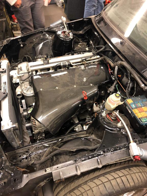

                Funny enough, it would be relatively trivial to do a CSL clone with MSS70. Honestly, its no-maf mode puts the MSS54 "alpha-n" to shame.
                Jealous of the airbox though! Theres nothing else like it. :)
                Build thread
                Bimmerlabs
                • Eyestorm
                  • May 2018
                  • 5
                  The MSS70 is newer and better(faster) then the MSS54 but the MSS54 is so well known to work whit so its much easier.
                  My engine has CSL camshafts, CLS MAP sensor and the CSL temp sensor so my DME have 100% stock CSL software only whit a few tweaks so it can run 100% perfect in E30. I also have the Mk60 whit DSC and everyting is fitted. Not just standalone ABS. And a manual gearbox from the Z4M.
