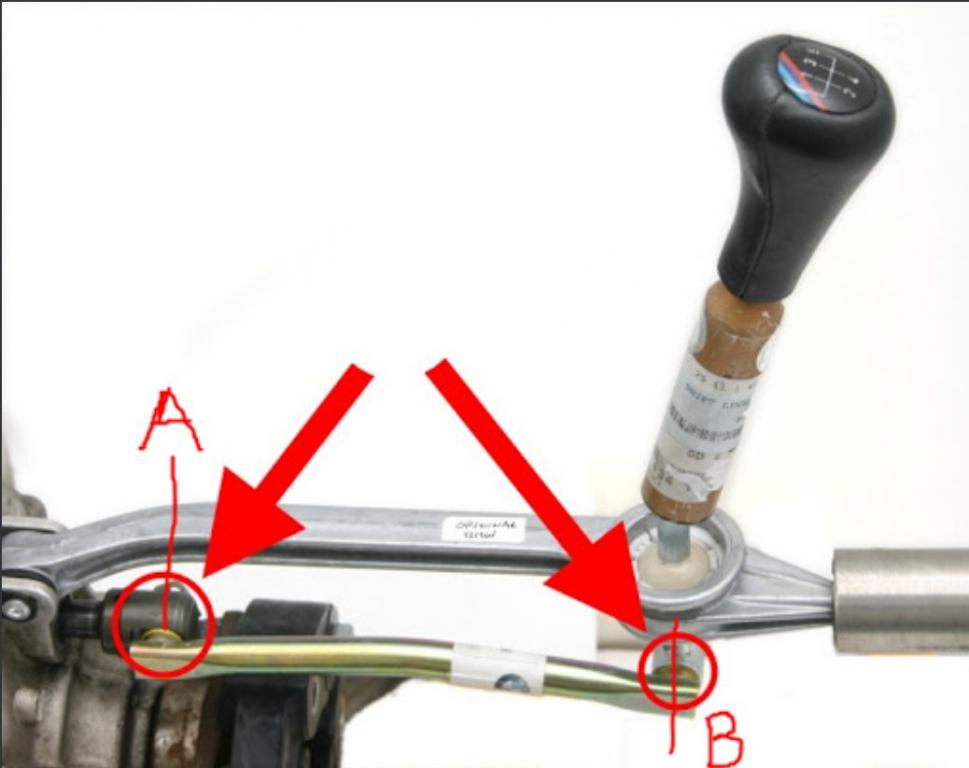

          Any one running chassis solid mounted shifter with with 6 speed?
          Also does anyone know the distance of measuring from the center of the hole on the selector joint (attached to trans) to the center of the hole on the shifter rod while using the evo parts using selector rod part # 25112228055
