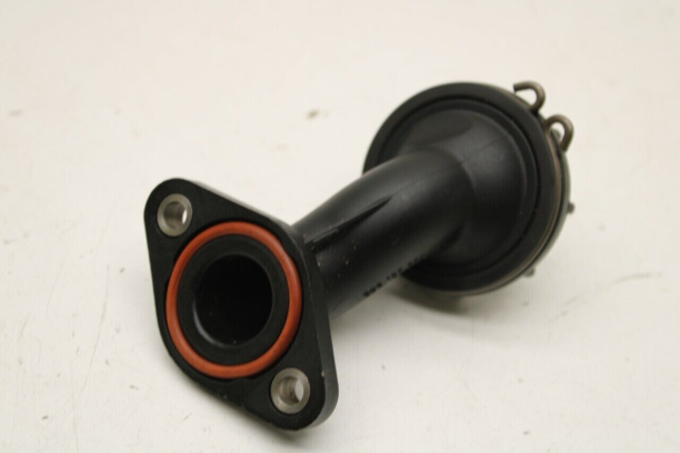

                Is that an oil pickup in the background of the fourth picture? Is that like an adapter to an M50 oil pickup or something? I see you're picking up some steam here! Great to see bud.
                • DEV0 E30
                  • Oct 2004
                  • 8904
                  #53
                  Yep, it's also a fancy machined piece.
                  I'm just the shmuck who got lucky that I can get these parts.
                  It uses a Porsche pickup, more on this later.
