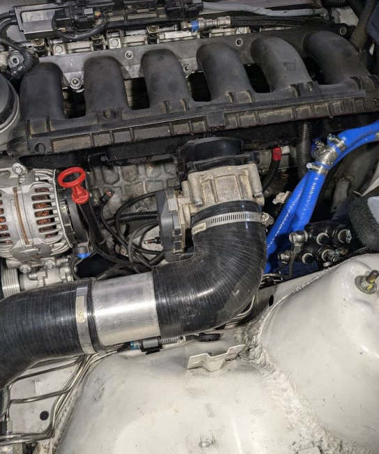

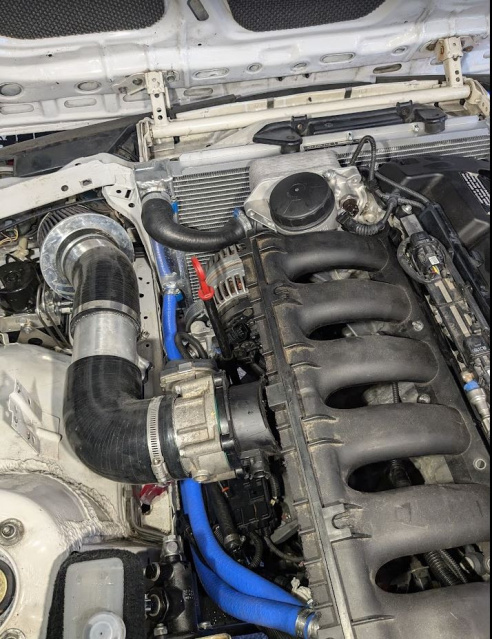

    I'm pleased with this!
    Nice thing about the "Euro" intake is that it opens up a lot of room where the DISA stuff used to be. I designed and printed in aluminum a little holding fixture that uses the stock E90 PS reservoir and positions it down and out of sight.
    Not up on the fender strut mount anymore, no more lines running down from there, but still accessible and functional. (still waiting on the correct washers...)

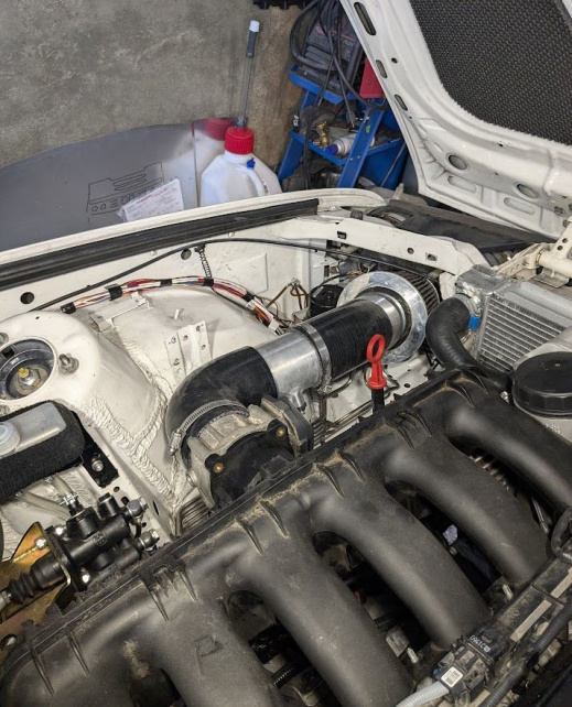

  • JRowe
    replied
    Here’s the wagon and some underhood pics. Looks like there’s room but would need to move the ps reservoir and perhaps get rid of the stock airbox.
    Leave a comment:

    Leave a comment:

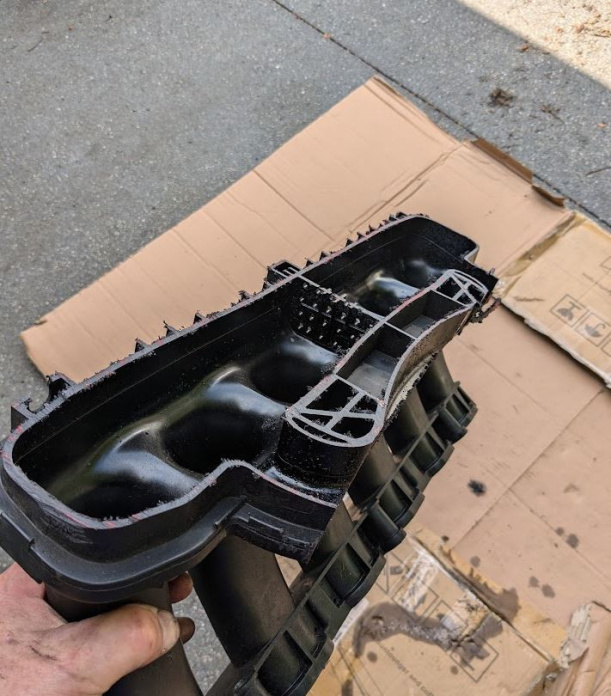

  • adam.nonis
    replied
    Originally posted by JRowe
    Looks like the way to go as far as N52 manifolds are concerned. Are people sharing a 3d printing file etc? I'd love to get my hands on at least two of these. Thanks
    Happy to share the files. Just want to wait until we get a couple more out and running. There's a few versions available too.
    Sent from my iPhone using Tapatalk Pro

  • JRowe
    replied
    Originally posted by adam.nonis
    Just the OEM flange and runners, cut off everything after the base runners and add a single chamber plenum.
    Leave a comment:
  • adam.nonis
    replied
    So, just trying to piece together exactly what the modified DISA manifold is and how to recreate it. Can you spelll that out in a “for dummies” kinda way. Thanks.
