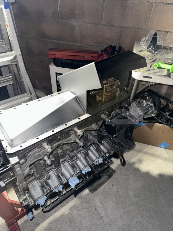

              After a summer's worth of researching wiring diagrams and networking with the other N52 swap folk on this forum, I am finally jumping into the next hurdle of finishing the oil pan that projectJTv4 had been so kind to let me see in person. It seems as if we are the only two people in the greater Los Angeles area that are taking this on so if anyone else is out here and willing to collaborate, let us know!

              Also did me a massive favor of lending the welding jig for the welder to finish it all within a week's time and get on to the rest of the challenges of getting the motor turned over and running.
