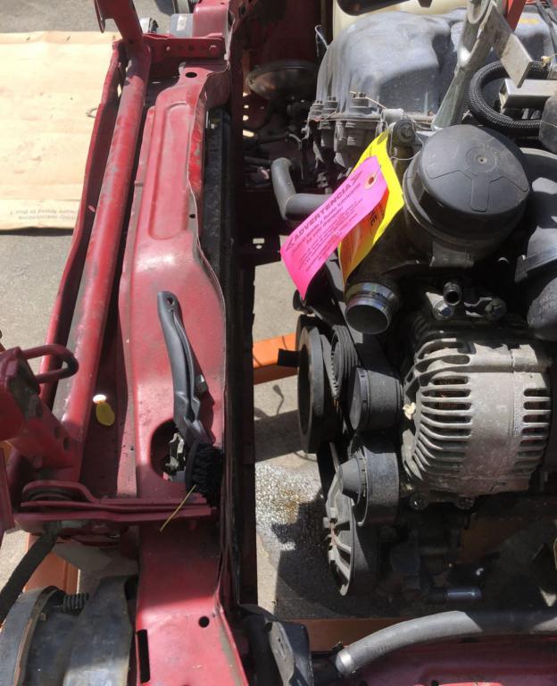

    Awesome updates.
    In regards to the radiator mounting, would a late model be better, or is it a moot point either way due to the radiator used?
    Simon

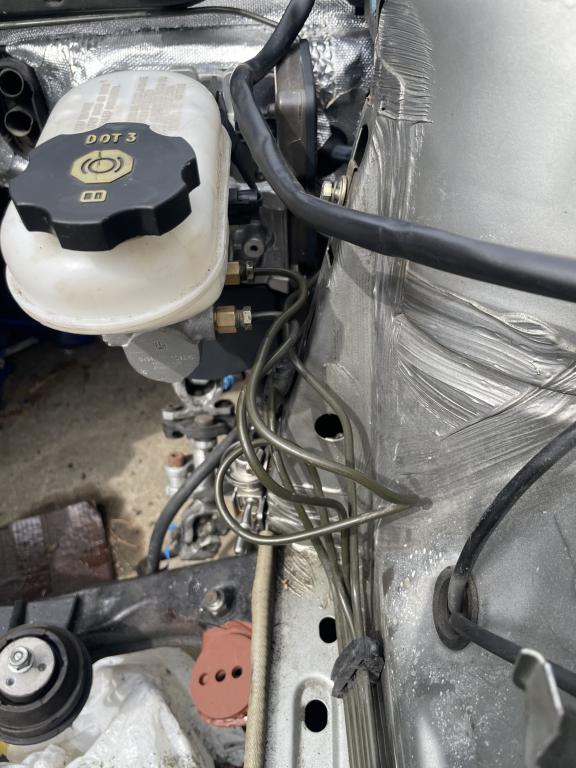

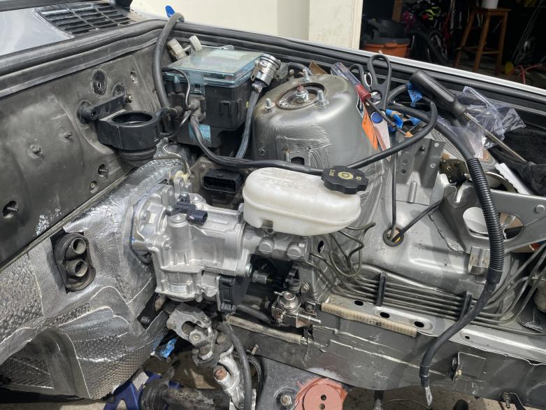

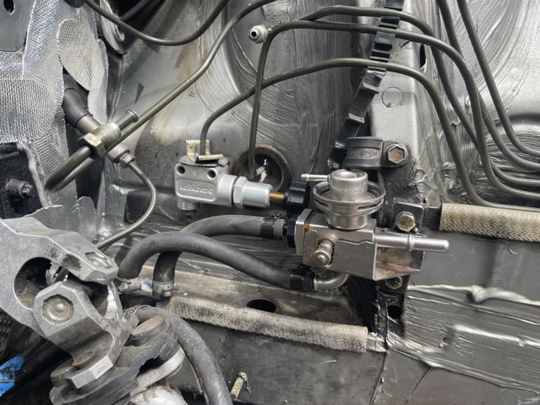

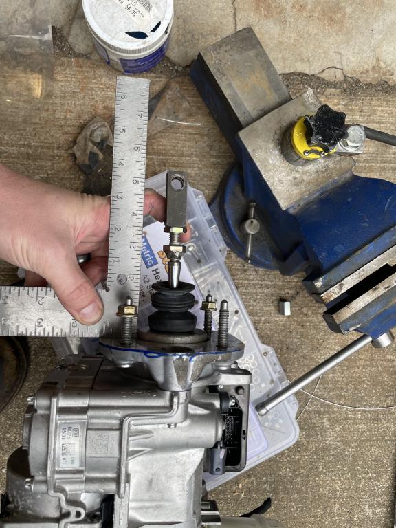

      I wanted to get a few components of the brakes and fuel figured out before the engine was in the way. Here you can see my bracket for an S54 fuel pressure regulator and a brake proportioning valve plumbed in the location of the old rear circuit delay valve. I used the mount location from the carbon vapor cartridge for my FPR... so I'm going to have to find a new location for that, but this meant I didn't have to weld a new bracket for the FPR and I can move it later if I absolutely need to:

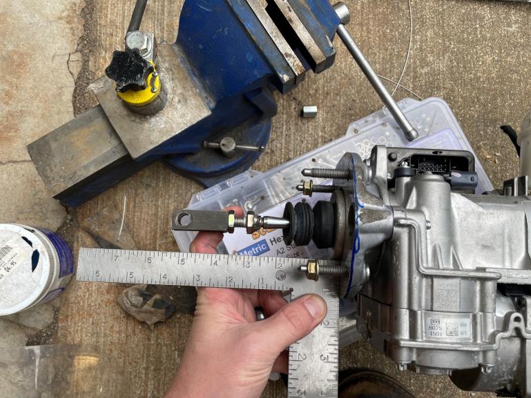

      Here's the e30 brake pedal linkage bzzzzz'd onto the end of the shaft of a bosch brake booster from a 2016 Tesla model S at the correct length (about 5"?). I expect this brake booster to work great but will reserve judgement until the car is moving. The reality is it's the only booster I can find that gives me room to retain the N52's 3-stage intake manifold. In order to get the brake circuit connections on the correct side of the master cylinder, I needed to track down the master from a right hand drive Tesla.
      Yea... it's not pretty. This are my original brake lines bent around to fit the new location via some brass adapters I found from Brake Hoses Unlimited, they call it a "Brake Line Thread Adapter, Male M12 x 1 Inverted, Female M10 x 1 Bubble"
      Looks like it belongs there! There are no changes needed to the firewall bolt pattern, I just have the booster section rotated 180 degrees to move the control box away from the engine (orientation for this doesn't matter):
      There's a few more things to clean up before the engine goes in... but it isn't much. I have at least some cleanup and re-mounting of the rack, fitting the new power steering hoses (why not now) and some rivnuts to place for that coolant crossover pipe.

            Originally posted by 2mAn
            Awesome updates.
            I don't think I'd choose a late model for the swap just because of the radiator mounting brackets, but it's one less thing to do if you have a late model. This rad should fit late models, and thus other late model rads should fit this down the line if I need to swap it. My car is an early, the mockup car was an '88 (transition) and the other N52 swap that hoveringuy has completed is a late car. We didn't run into any huge advantages of one revision over another.

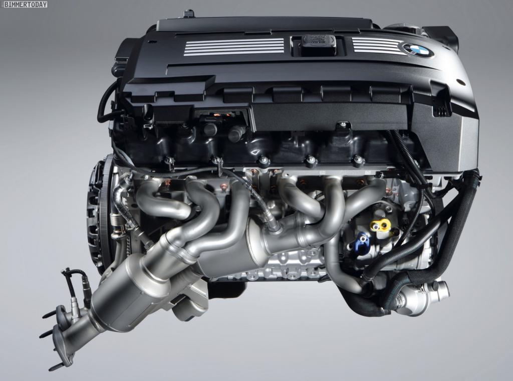

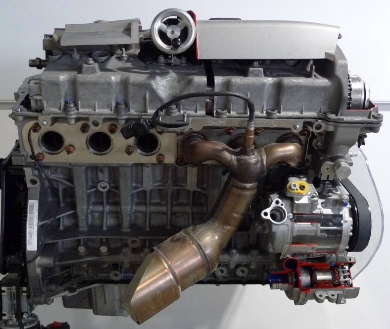

                    The first option for an exhaust solution is the easiest. Every factory north american n52 comes with very, VERY compact exhaust manifolds with a boss for the only O2 sensor you need. There's two banks of 3, just like most BMW 6 cylinder systems, and they're identical after you cut off the catalysts. Sourcing them unless you have a complete donor car is a *little* tricky because the catalysts themselves are regulated, but there are yards that are happy to cut them off, and they're plentiful. This piece goes in the recycling bin at every wrecker because they come off with the catalysts.
                    Click image for larger version  Name:	BMW-N52_Abgasseite.jpg Views:	0 Size:	67.2 KB ID:	10029724
                    There's tons of room to work out how to Y these together, and I think they'd look and perform fine. If you *really* want to do some math, there's ideal distances for the union to control exhaust pulse timing between the two banks, so don't think that just because the manifolds just mash three cylinders together that you can do the same as close as possible with no ill effects: the 6 cylinder firing order alternates between the front and rear banks.

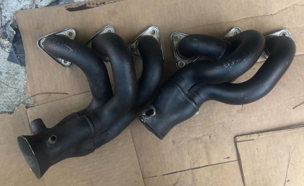

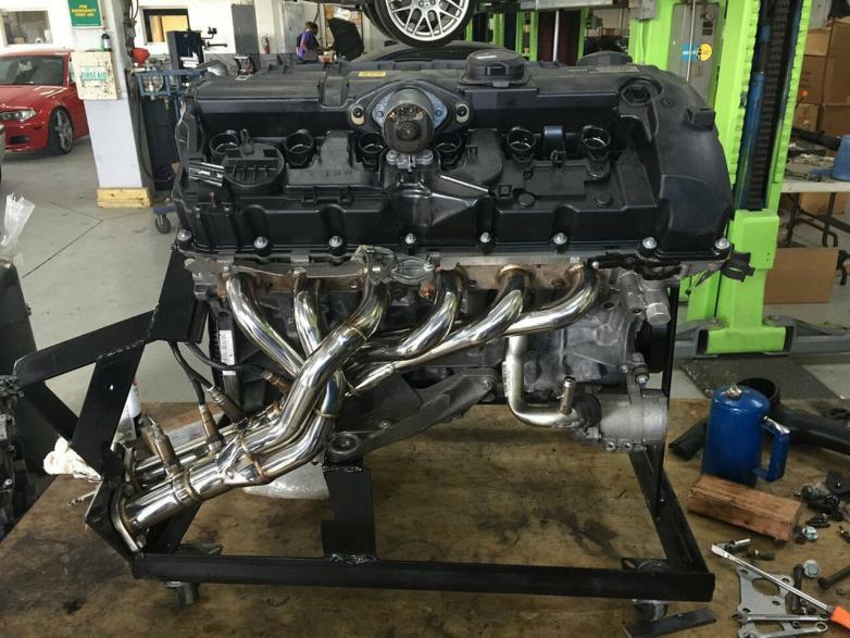

                    The next option is my golden goose. There ARE factory manufactured equal-length short tube headers for the N52. It's totally unclear to me which models they were fitted to, and they seem to *share a part number* with normal looking 3-into-1 manifolds depending on which european country they were delivered to... I don't trust images on realoem or other fiches to correctly represent what these manifolds look like, but I have seen 2 sets for sale in europe and russia. Since these also have catalysts attached they're even more complicated to bring into the country. Many hours were spent lying awake thinking about these headers.
                    Click image for larger version  Name:	BMW N53 Engine picture.jpg Views:	0 Size:	78.4 KB ID:	10029725
                    This makes me think that BMW saw some value in developing and manufacturing the short-tube headers where they could get away with it, and figuring out some type of equal-length header became a priority. Custom headers cost as much as my entire project (which ain't nothin) so the answer became "adapt s54 headers to the n52." These headers are EVERYWHERE in the US... and they're *cheap* due to the number of people discarding them to replace factory manifolds with long-tube aftermarket headers without catalysts. This is $40 worth of hard to make parts from an S54 Z3M:
                    Click image for larger version  Name:	s54 header.JPG Views:	0 Size:	64.3 KB ID:	10029726
                    And here's what they look like after you slap your forehead and realize the bore spacing is the same, make some little tube extensions in the right diameter, and cut flanges to match the N52 manifolds:
                    Click image for larger version  Name:	IMG_1983.jpg Views:	0 Size:	98.3 KB ID:	10029727

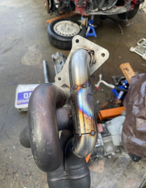

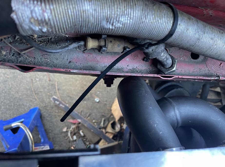

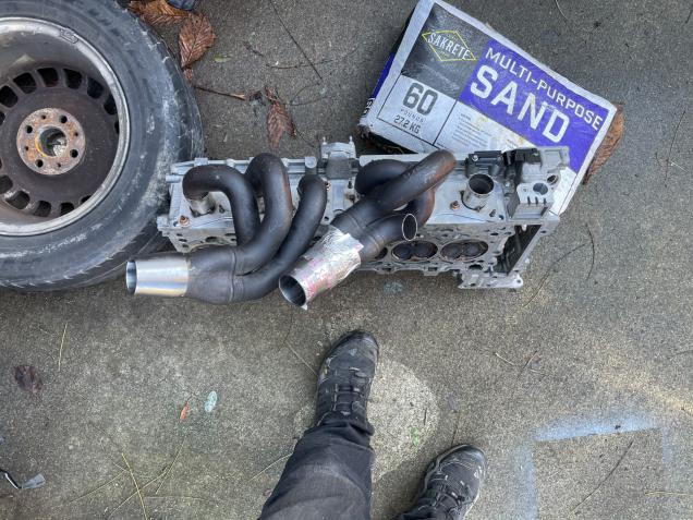

                      WELL, that was the plan anyway. Unfortunately... This approach isn't perfect. The geometry on these primaries is great for the m50x air conditioning compressor location, but conflicts with the location on the N52. Scroll back up to those super fancy european headers to see how close this is and how the factory euro headers deal with it:
                      Given the option of changing the shape of the AC compressor and changing the shape of the cylinder 1 primary... I chose to chop out the problem runner and keep moving. These 2.5" to 2" reducers take the size of the union where it goes into the catalyst and brings it down to a more managable 2" diameter. Bank 2 here is tacked on, and bank 1 is taped on to check the angle of departure of the cone. The aluminum foil tape turned out to be super useful for mocking up and tacking tubing. It's fairly strong in tension, very thin, and super easy to scrape off and clean to be able to tack a few spots while the joint is taped together.

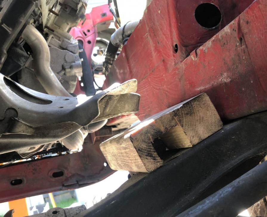

                      Cylinder 2 is the sticky-outest of the primaries, and just barely interfered with the frame rail. Post 12 in this thread shows the fix for this... here was the problem being discovered:

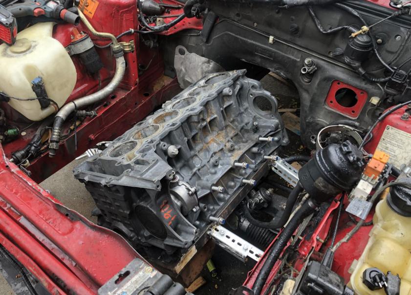

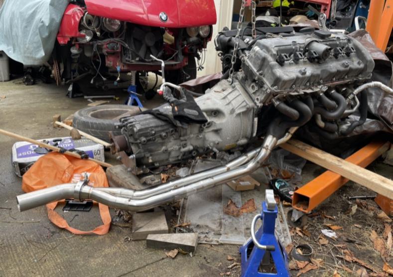

                      There was a lot of moving the front two banks back and forth between the engine block mounted in the mock-up car and the engine (which had the transmission mounted). The sleeved connections along side the transmission should give me some leeway when I go to re-assemble this in the car.
                      Once everything else looked like it was going to work, I went back and built a new cylinder 1 primary around the AC compressor. I don't have a ton of clearance, but it's probably as much or more as the euro... and I realized I've completely borked my equal-length math... but I wanted AC and wasn't starting over!
                      I just realized I'm referring to an engine block mounted in the mock-up car and I haven't gone through how it got there. sigh. It sounds like engine arm geometry and engine position better be the next update.

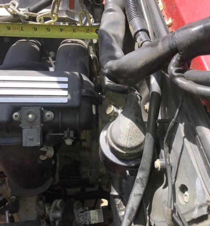

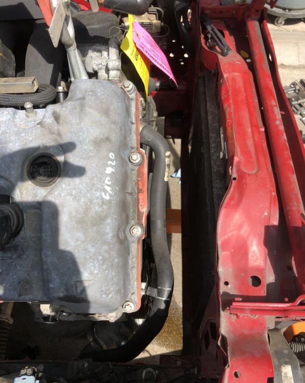

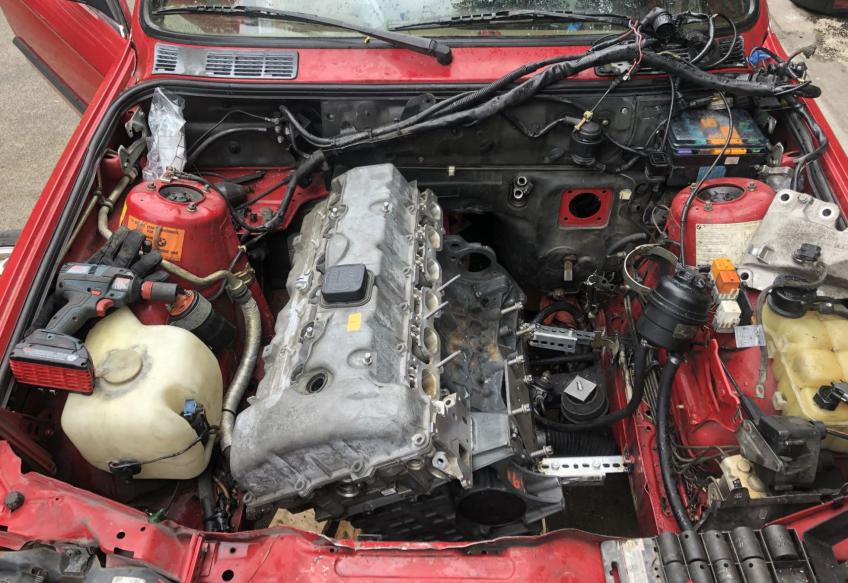

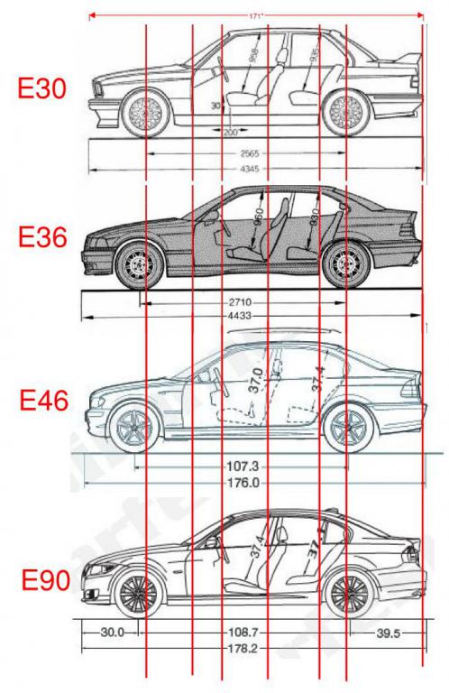

                            Ok. This is the story all about how... I settle on an engine location and got it to stay there. All BMW swaps take advantage of the offset in engine and vehicle generations where and engine will span two chassis generations, and a chassis will get a mid-life engine update. The M42 was in both the e30 and e36, the M5x was in both the e36 and e46 and e85, and the N52 was in the e85 and e90. Because of these factory interchanges, we don't see vast changes in geometry.
                            When we try and locate the engine and transmission relative to the car, there are 6 degrees of freedom. There's translation along each of the three principle axes (forward-backward, port-starboard, up-down) and there's rotation around each of these axes. The more of these we can eliminate by making decisions, the fewer we have to scratch our heads about. The first axis I'm going to think about is forward-backward, because I think it's the easiest. This is an engine that came from an e90, so I think it's useful to see how the dimensions changed between generations:
                            One of the considerations when aligning the engine front to back is the location of the shifter. I started with a 330i engine package, and the shift carrier (the aluminum casting that spans between the transmission and body and locates the shifter ball) is common between the 1 series E81, X1 series E84, and all E9x 3 series variants. The length from the shifter to the front of the transmission is related to the distance between the hole we have in our tunnel and the firewall. Looking at how relative dimensions have changed with generations of the 3 series, it doesn't really look like the driver position has changed relative to the firewall. The front wheels shifted forward between the e30 and e36, but we know that was because the front axle and oil sump swapped places. I started off with the assumption that if the shifter position from the e90 worked, there was no reason to mess with it. Rotationally, we know that single cam 6's lean at 20 degrees (like the M20) and that 24v 6's lean at 30 degrees (M5x, N52). It's easy enough to measure this angle, so two degrees are locked down: Longitudinal position and rotation.
                            The translation in the horizontal axis (the line between the front wheels) is fairly easy to get a starting point. Motor mount pickup locations are symmetrical on both the e30 and e90 subframes from measurements of the motor mount pads vs the ball joints. If we mount the e90 engine arms to the n52, drop it under the hood of an e30, and wiggle it around until the motor mount bolts holes have equal distance to the frame rails... that's your starting point, and don't move it if you don't have to. Rotation around the horizontal axis (rotating the engine package around the line between the front wheels) is easy to make small adjustments to after the fact, because the motor mounts allow a few degrees of rotation. You can see the impact of this angle in a cross section of the e30:

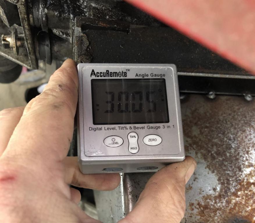

                            Looking at the driveline, there's a slight declination to "point" the transmission output shaft at the diff input shaft. This doesn't give us much room to make decisions about this rotation. We have to match this angle within a half degree or we won't be able to correct it... and if we're wrong, we want to be on the upper end of our range at the back up the transmission so we can tilt the engine down a little further by shimming the transmission mount (adding spacers or washers between the crossmember and frame).
                            That's four of six degrees where we have clear guidance. Translation in the vertical axis is a compromise between the space between the valve cover and hood, and the space we have left under the engine for an oil sump. It's also critical to our driveline diagram above... we don't just have to match the angle of the driveline, we have to match the height, or there'll be a vertical offset at the transmission output. We don't have two U joints like a pickup truck to make-up this offset... This driveline isn't expecting the diff to be moving up and down. As long as we're pointed at the diff, and we have room under the hood and above the crossmember, vertical position is what it is. Rotation around the vertical axis is straightforward: Aim the driveline at the diff.

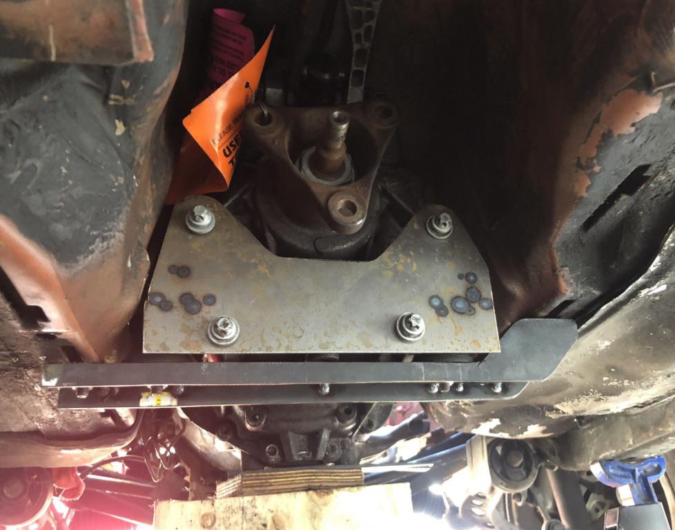

                            That's all we have to know to lock down the engine position. Now... how to build it... fabricating and welding engine arms around a fully assembled engine with plastic parts didn't seem like a great plan, and I only have one engine. I needed something disposable to mount fixtures to, so I built the not-a-sump:

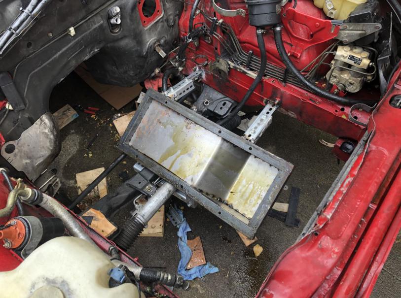

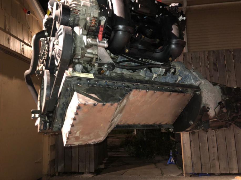

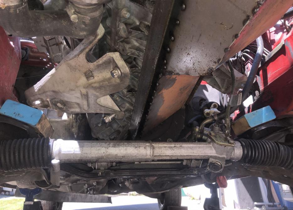

                            This does two things: it lets me remove the rear sump that conflicts with the e30 subframe, and it protects the delicate underbelly of the engine from the environment and my prying and scraping. The lump at the front of the engine is just large enough to accomodate the oil pump, because if I don't have to take that off, why would I. Once the engine package is under the hood with the not-a-sump mounted, I can start jacking, shimming, and measuring. I left the e90 engine arms bolted to the block and gave myself a wood platform to sit on and slide around:
                            It was a huge pain moving the engine around while the transmission was supported on a jack or blocks on the ground, so I made a rough transmission mount first. The way the floor pan works, sliding forward and backward isn't a problem, and the location side to side is pretty clear... I can jam about a finger either side of the trans between the tunnel and case. We later found that the 325i and 328i have a much smaller transmission than the 330i, and it might not have been so obvious. With either of those donor cars, your factory e30 manual crossmember will work here:
Name:	trans mount.JPG

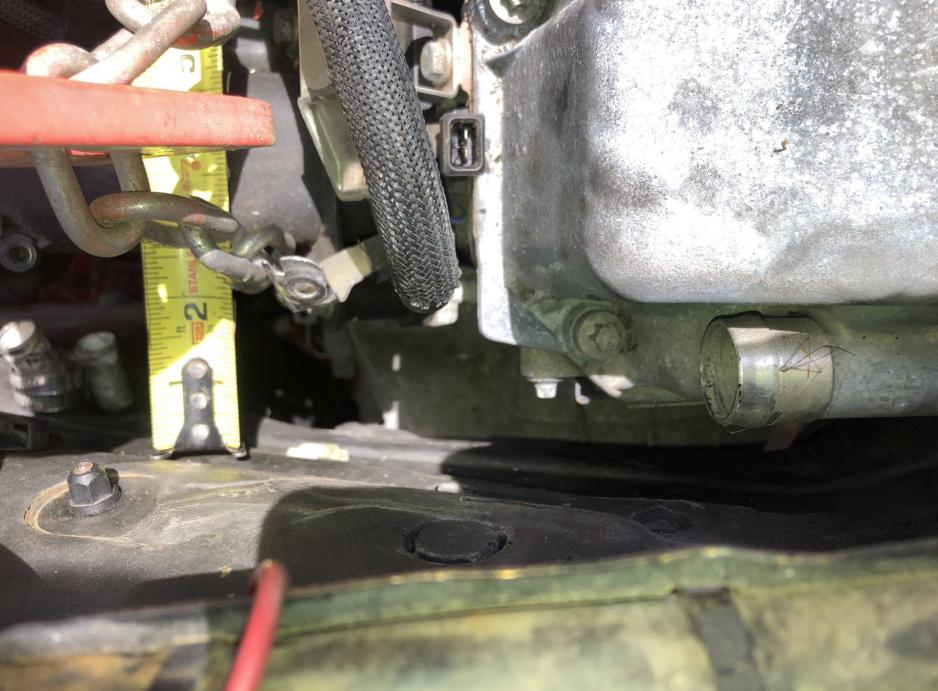

                              After probably 3 weeks of wiggling and asking friends and doubting myself and putting hoods on and off and measuring, I ended up with "enough room in front to probably still fit a radiator"
Name:	Front Distance.JPG
Name:	Front distance 2.JPG

                                So much wiggling, checking what that changed, shimming again, checking to make sure it was still centered... One final check of the 24v lean angle:
                                And now, the not-a-sump magic. I have big ugly mild steel hanging down under the engine that I can lock off to the chassis. Way too fiddly to unbolt the block from the not-a-sump to lift it out, and no way to tilt the engine while it came out the top, so the fixtures had to be removable:
                                So glad I didn't decide to try and build my arms like this. With the fixtures unbolted, the engine package removed, and the not-a-sump swapped back into the car, we have a perfect negative of the block location under the hood:
                                It doesn't look like much, but I could stand on this. It absolutely represents the location and rotation of the engine as it was under the hood. If you're the kind of person who's been tripping over a bare N52 block in your basement for a year, you can carry it outside and bolt it in place:
