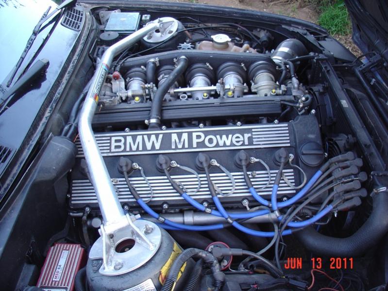

    Here are a couple more pics of the car.
    Cheers,
    Jim
    • Xat1cZ
      • 2020
      never really put much notice on the difference between B36/8 intake compared to the B35 intake until now >.<
      edit: where does the pipes lead to? behind the bumper? do you have a small cone filter on the end or .. ?

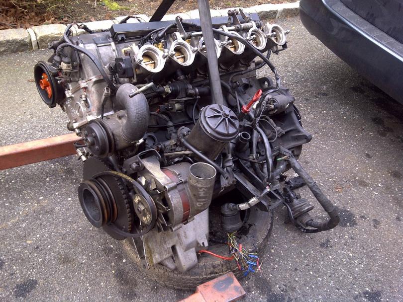

        My engine is still in the rebuilding stage but I plan to drop it in early May. I cant wait.
        Engine before tear down last month...

        The Build:
        • Xat1cZ
          • 2020
          GL with the swap and don't hesitate to post some pics of the rebuild :up:
          • e30m3s54turbo
            • Jun 2010
            • 3277
            It is a 4" silicone tubing + a 8" cone. It sits be hind the fog light an I took the euro tow hook cover to let fresh air in
            • ttrousdell
              • Nov 2009
              • 1770
              Thanks dude. All the pics so far are on the build thread which i'm constantly updating. Your s38 M3 is beautiful :bow:
                Thanks for the info , I might be doing this for my car , I was originally thinking of putting on one of the Gruppe M style CF intakes like Simota offers and I've seen some by Racing Dynamics aswell altho' the latter isn't in production anymore ...
                but I like your setup alot more than that :up:
