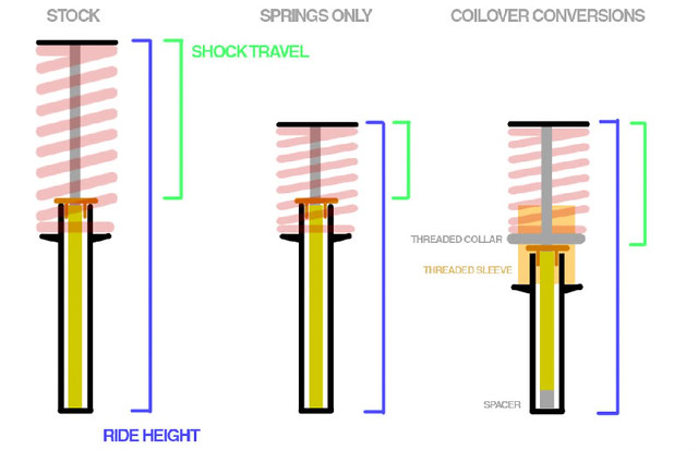

        You can also use regular iX sport Koni's on shortened (i) strut housings. I believe you would want to go with Race Koni's if you are thinking of doing more than 500/lbs springs at front (do not quote me on that number).
        Regarding the travel, obviously you will have less shock travel if you are lowered and do not have short housings.
        i.e.,
        Click image for larger version  Name:	image.png Views:	0 Size:	116.1 KB ID:	10086740
        This is the process of shortening your housings:
