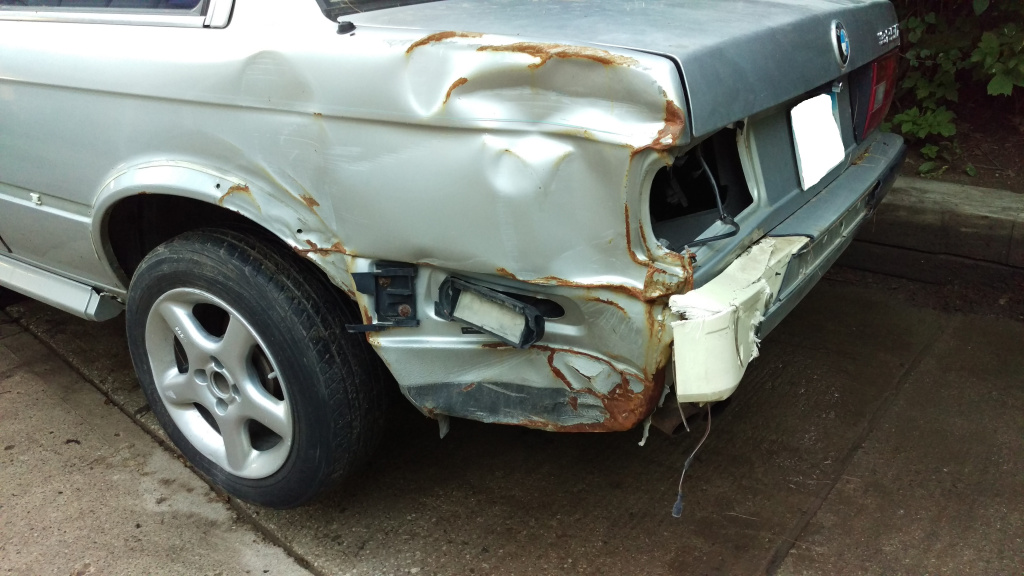

    Have access to a E30 333 111 354 56 E30 rear axle carrier to replace my damages 325IX axle carrier.
    I have a 1991 325ix that was in an accident (years ago and bent both the axle carrier brackets and the rear trailing arms.
    Traling arms have the same part # as all other E30s 33321137641 and 42.
    I pulled a complete axle from a parts car I have and was thinking of making a SWAP when I noticed the carrier has a different part# 333 111 355 46 (like they couldnt make it any closer)
    I read they can be used / swapped but need a different bushing? Is this true? If so - what bushing do I need? the IX?
    Any help on this would be appreciated.
