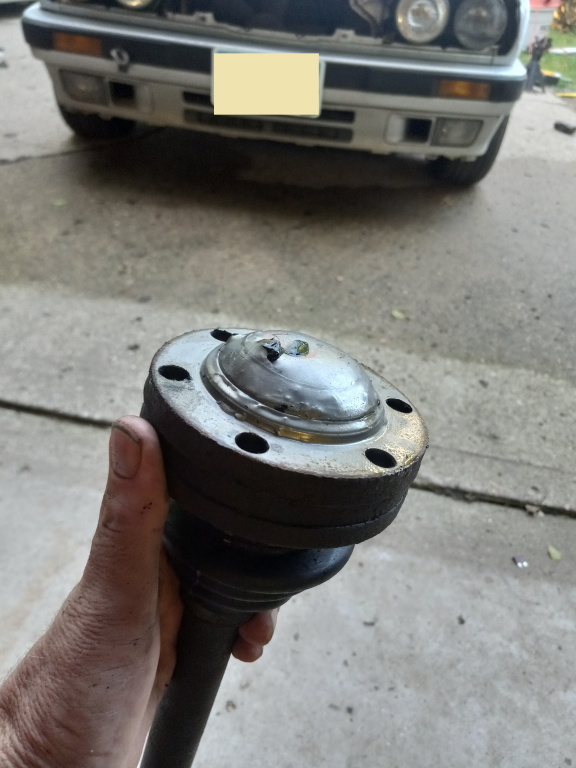

Name:	broken shaft.jpg

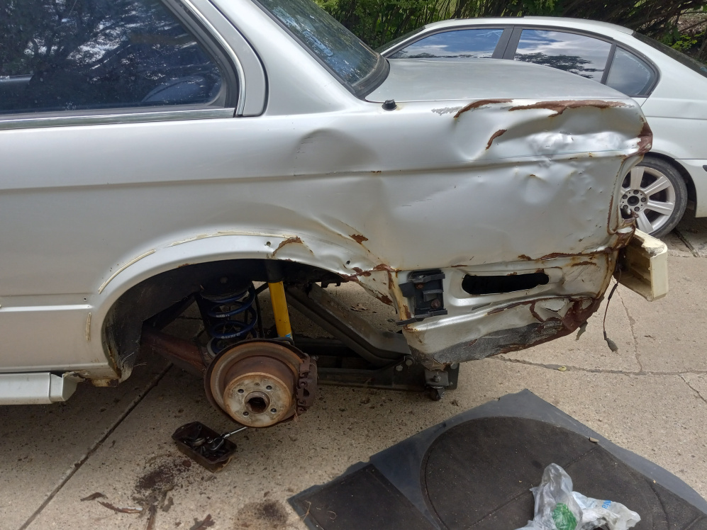

    Side note - I installed a regular 325I shaft in order to drive it in and around the block if needed.
    Got it running and driving and street legal (sort of) - although the axle is bent and the drivers side rear tire is pointed outward

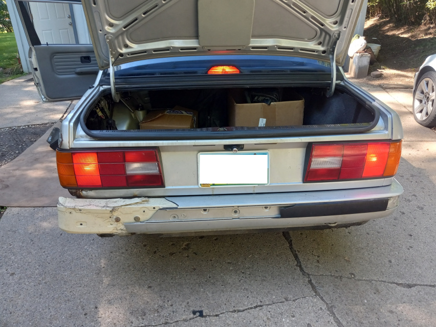

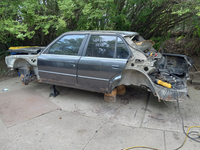

    Here is the parts car: I got all the rear bumper parts needed to replace and the rear axle carrier and trailing arms:
