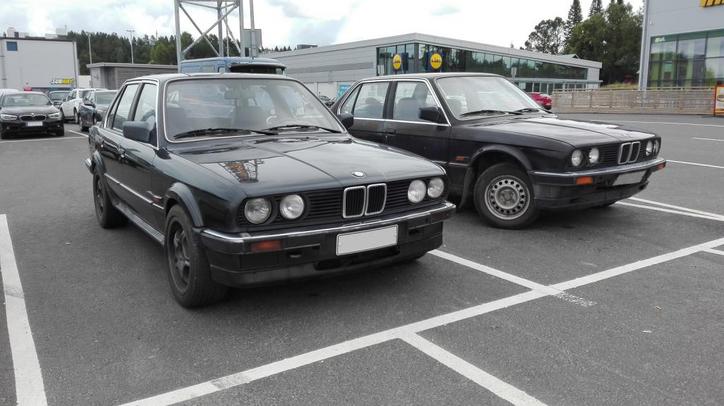

              16x7,5 ET35 Arbets on mine, these will be winter rims. 205/50 tires now, no rubbing at all.
              Finding proper summer rims is a bit of a problem, good looking 16" tend to be 8" ET ~25 which seems too low..
