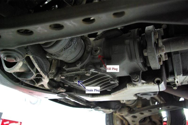

    So if you gotta read this, you shouldn't be changing your fluids anyways, I suppose. But this is the first of several I plan on making over the course of bringing my run down 1990 325ix back to life.
    If youre a novice, its pretty simple....loosen the drain plug and let the fluid drain out. With the plug removed, depending on what youre draining, check for metal chunks or debris that that are stuck to the magnetic plug. Large chunks can be cause for concern Use an appropriate filler pump to fill the component (tranny, diff, etc) from the top plug. Once the fluid begins to drip out the top of the plug, its full. Tighten accordingly.
    Feel free to add whatever you guys think is good, I'll be making a nicer, cleaner looking PDF version.
    Next week I'm having Ryan G. change the CV boots. He's going to try and take some pictures for me that I hope to post up should anyone want to attempt this at home. Additionally I'll be doing shocks/struts (at some point), dropping parts of the transmission to rebuild the shifter and service the drive shaft(s).....all of which I hope to get pictures of.....
    Using a pump to fill back up:

        pics of the transfercase fill/drain would be good. people are always asking about that.

          you might mention that the most important first step is to get the fill plug loosened before you drain all the fluid out... dont want to be hosed if the fill plug happens to be stuck
