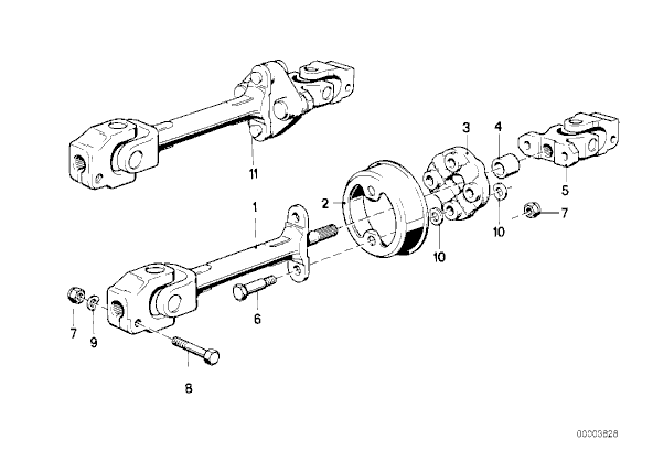

              • Heysüß
                • 911
                was it any of these? the u-joint you replaced?
                I also have a loud clunking sound right behind the steering wheel when going over bumps such as railroad tracks and the steering has some play. I actually got to witness the steering getting loose since I bought the car, the sound right behind the steering wheel got louder and I felt the steering get less and less precise.

                  none of those are ix parts, but it looks sort of like the one on the very end of the shaft.

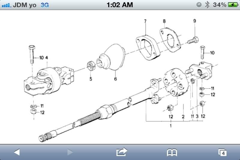

                      I'm gonna be a bit lazy and ask what all needs to be removed to inspect this section. The bentley is pretty bad about explaining the assembly about this area of the car, all they have are two or three pictures of a bolt or two.
                      09/1989 325i 4 Door
                      +M30 Swap
                      +Z3 Steering Rack
                      • nando
                        • 34839
                        on an ix? you need to remove the bolts from the u-joint, loosen the slip collar on the shaft (so you can push it up into the column) and remove the u-joint itself. You can't tell how worn it is if it's on the car, mine was popping loudly but there was no noticeable play when I looked, until I actually removed it.
