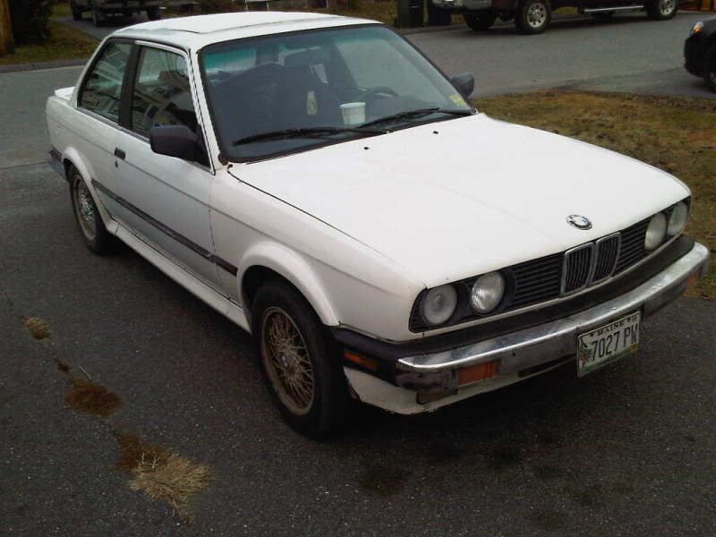

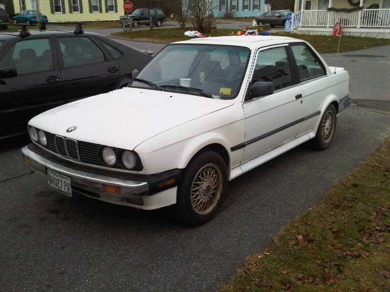

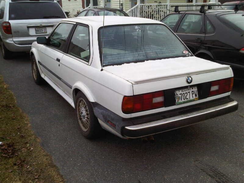

    Hey! just picked up an alpine white e30 325ix for $500 on craigslist. I've spent a few years tuning. Mostly with SAAB's and VW's and figured I'd try something new.
    The 325ix has 133k original miles and came with a ton of new/used parts. It is a little rusty and soft in some spots but nothing I cant take care of.
    So since I'm new to BMW let alone the ix I was just wondering if someone could place me in the right direction of tuning... Parts and upgrades to look into for the m20. Mind you this isn't a daily driver. Just a side project for restore/performance.
    Part of me is leaning toward turbocharging and yes I will do some searching on the topic... The m20 can take what? 400-450 on healthy stock internals but I'm kind of weary about the drivetrain. Some say that the awd doesn't hold up well and others say with fluid changes and proper maintenance everything will be fine.
