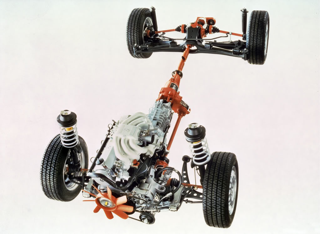

    hey do you guys know if its hard to convert an automation 325ix to manual trans? idk if this question was asked before.
    can you just used a normal all wheel drive manual trans? or there is drive shaft problems and stuff?

    swap transmissions. install pilot bearing, clutch, pedals, MC, slave. modify wiring to bypass automatic start wiring, hook up reverse switch. re-use all the original driveshafts and mounts.
    it's a little more detailed of course but that's the basics. you need an ix-specific transmission and a manual transfercase.

      So I cant use the original transfercase?

        not without swapping the front half of the automatic case to the front half of a manual case.

          so the major components that i need is the transmission and transfer case. (how hard is it to find those)
          and then of course all the other little stuff

            also- the ix shifter parts are ix-only, but those can be bought new for not all that much. you can use a Z3 1.9l shift lever.

                the auto transfercase doesn't bolt up the same. I already said everything that needs to be said about that. :)
