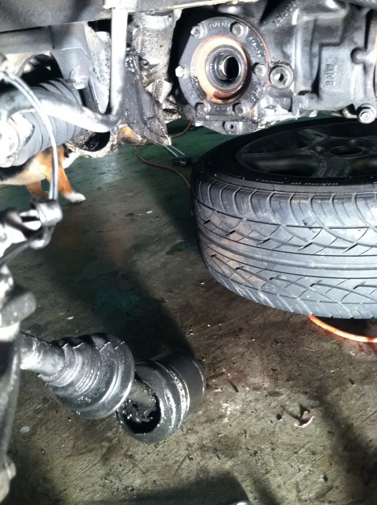

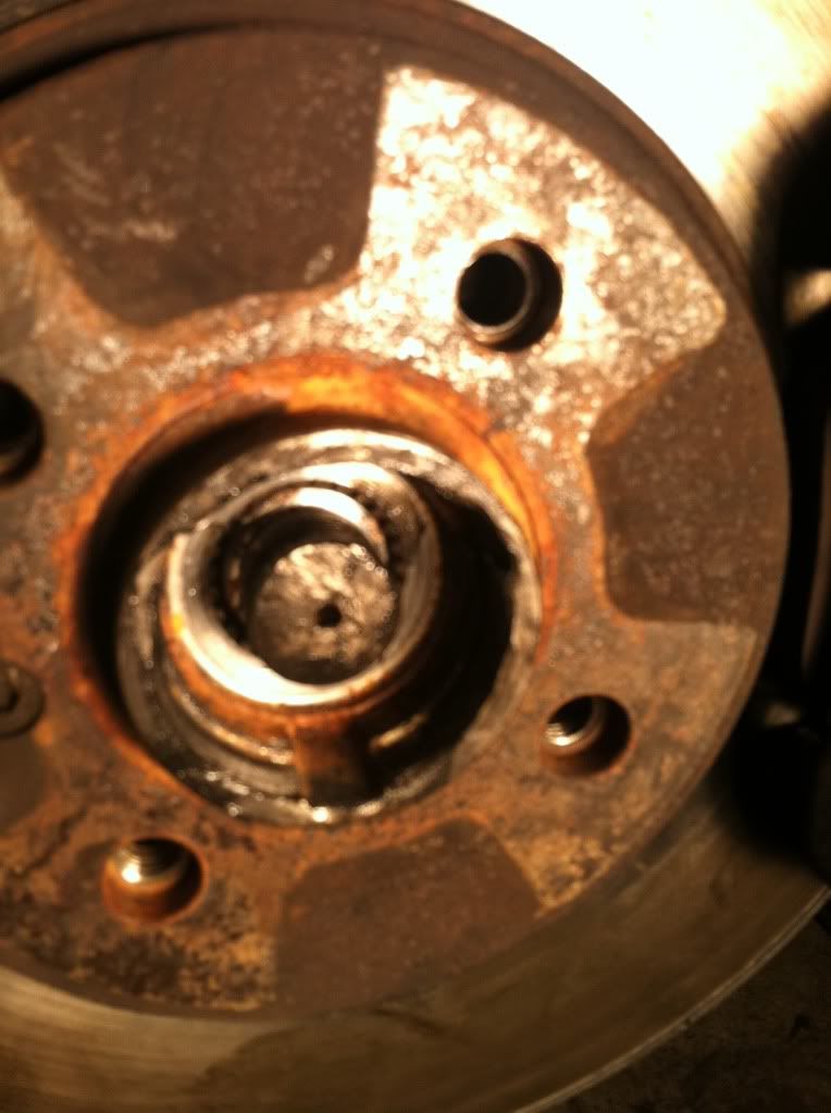

    i got the back part out from the diff. i got the big nut off on the hub and its supposed to pull right out, but i cant seem to get it out at all. i tried hitting it with a hammer to slide out easier, but still nothing. should i try something else?

    ouch man. NEVER hit it directly with a hammer. You'll mushroom the end, and then you're screwed.
    Can you still install the nut?
    I always put the nut back on a few threads and then maybe the socket on top, then start whaling on it. PB Blaster or your favorite rust inhibitor to soak if it's REALLY stuck, and then anti-sieze when you re-install.

      Try this, some kits wont have 12x1.5mm. You could get 2 bolts, and perform field expedience.
      Last edited by cabriodster87; 11-18-2011, 07:05 AM. Reason: Use the shortest bolts possible. OR choke up with washers.

        dude you should have talked to me. I've got a hub puller that works perfectly for the ix. woulda saved you a mushroomed CV end. :(
        also when you put it back together clean all the splines with a wire brush, then lube with copper anti-seize. The last time I had my CVs out I pushed the shafts out of the hubs with my finger. :)

          I used a large punch and a hammer to get mine Dead center
