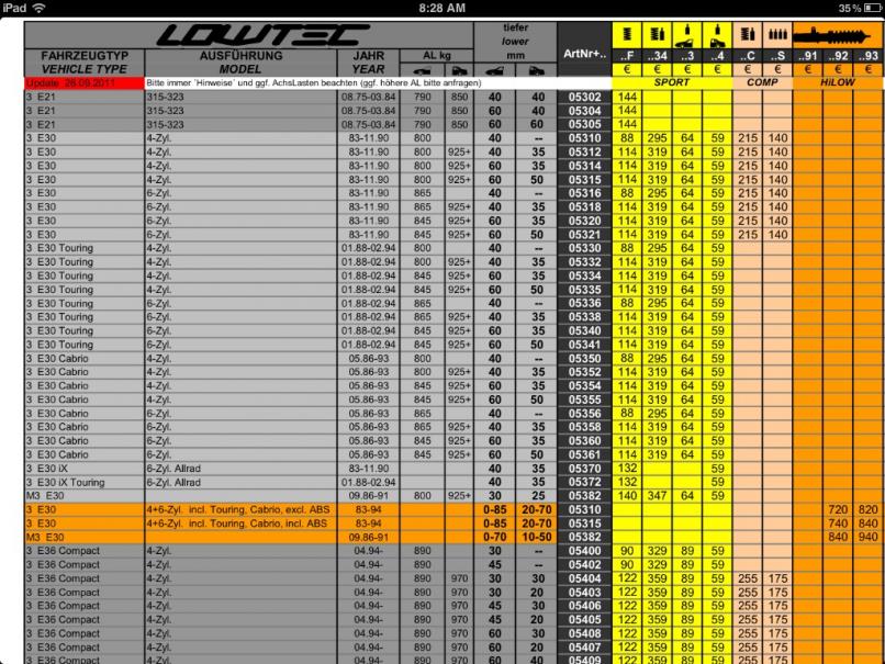

          The front springs have 151 printed on them and the rears 401. I'm not sure if those are the rates though. I don't have the accompanying literature to hand currently. No matter though as its all in German.
          I have attached the info from their website:
          Thanks for your answers. It has confirmed my thoughts. I have decided not to put the lowtec springs on and to keep stock suspension geometry. I believe the PO changed the front to HD's but not the rear.

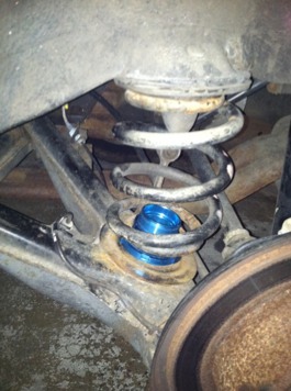

                            Bilstein hd and h&r sport is such a massive improvement over stock. It's what I ran on my last ix. On my current I'm running new oe struts on the original springs. Although I just modified the rears to use the jom adjuster to raise it. All this won't last long though, I miss my old set up.
