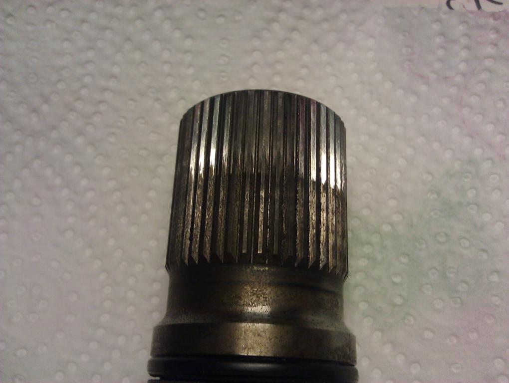

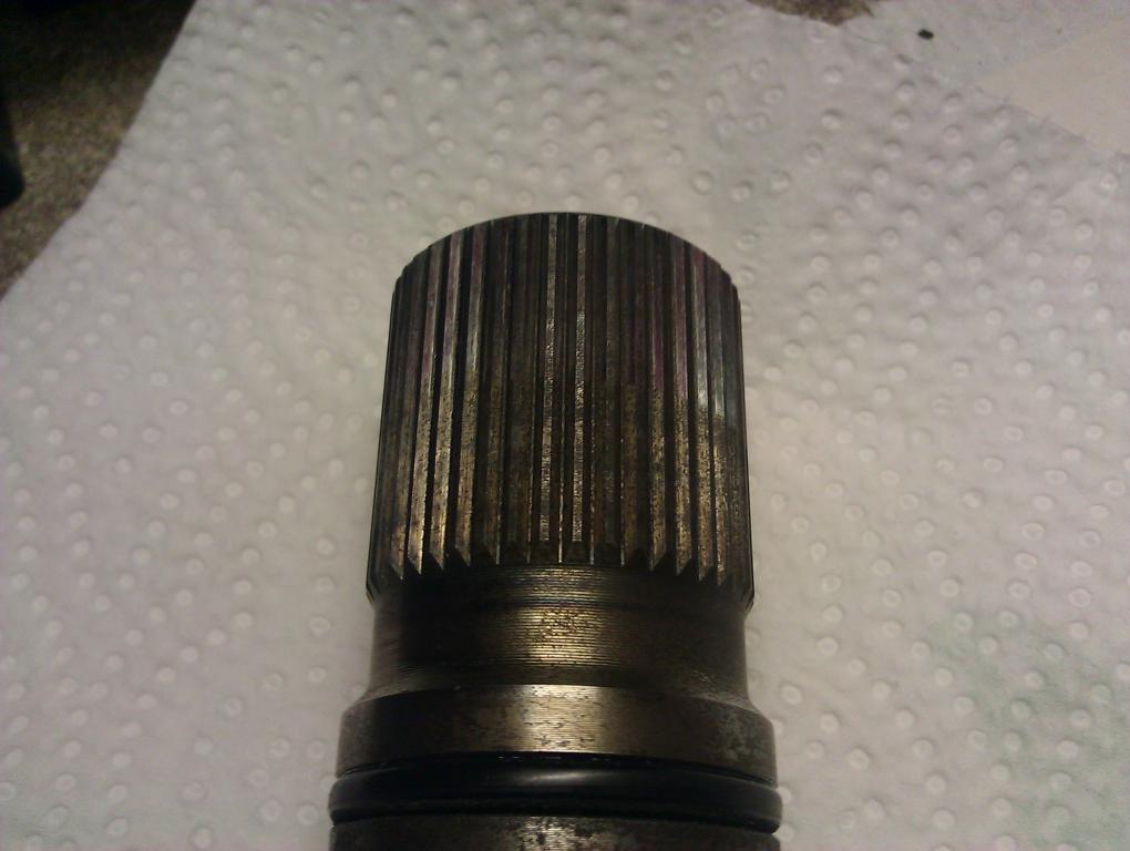

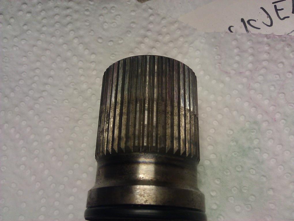

                        I don't know the fault tolerance on this.. but to me it seems OK.
                        There was very little grease in there.. I almost did not get dirty. Could that cause such problems?
                        But something is slipping... whats next.. the chain?

                          looks a bit worn. Mine looked similar, and was stripped enough to make a loud metal clanking noise audible from a block away. One way I tested to see if it was in fact bad, was i did the 'jack test' with the back wheels up in the air. I put the car in gear, and slowly tried to move the car. Good enough, the sound was 10xs LOUDER & the front wheels weren't hooking. My transfer case was just rebuilt, so I knew it wasn't that.
                          Did you wiggle that shaft when it was inserted in the transfer case to see how much play there was? You should be able to see if there is....with the plastic cover removed.

                            splines look OK. you can get the proper grease from a BMW motorcycle dealer. dunno if a BMW car dealer will have it (they're usually clueless on older BMWs). you definitely want it greased or it won't look like that for very long. :)
                            How about the front diff? it's a more likely failure point than the transfercase chain, although that is possible if it's been run dry for many miles. you could try draining the fluids and see if there's any metal shavings. drain the transfercase and see how much is in there - it doesn't hold much, about half a liter or so.
