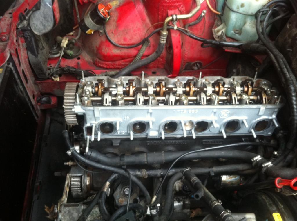

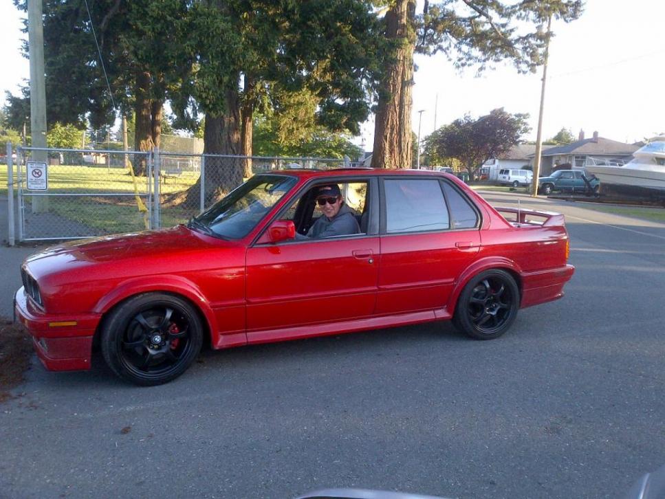

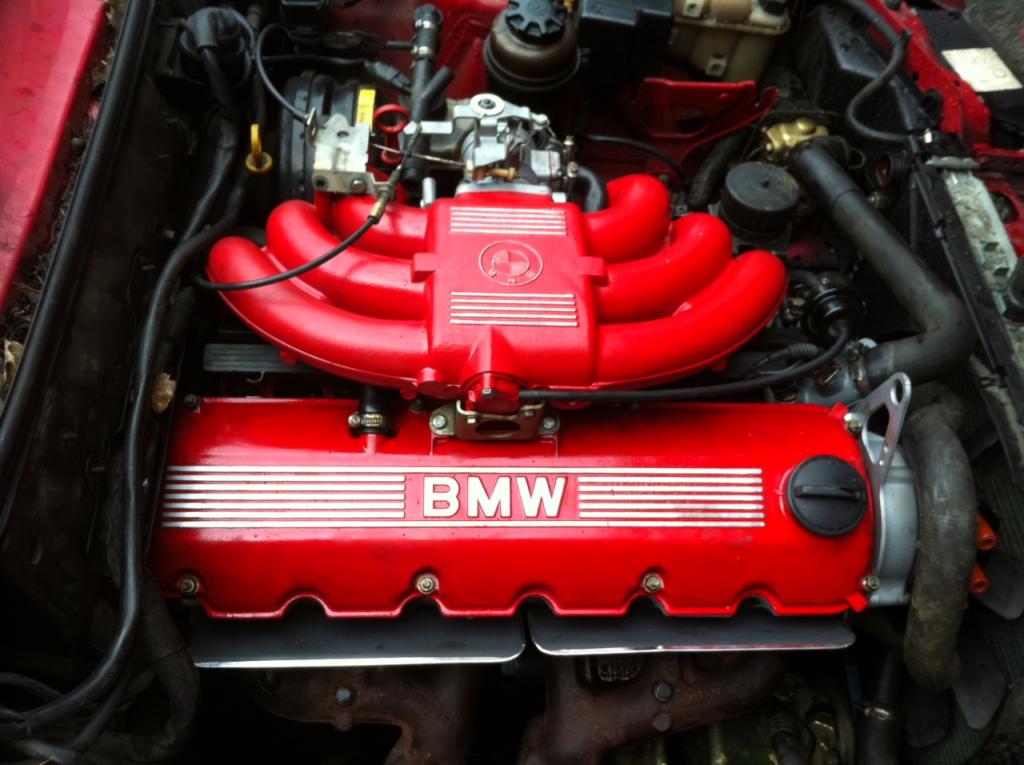

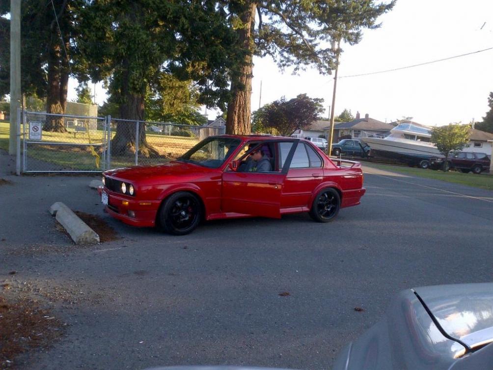

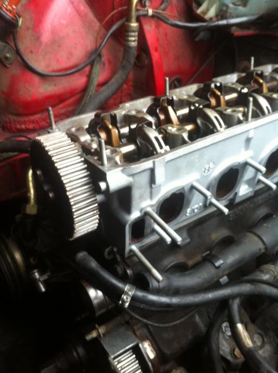

    About the car: BMW 325ix E30. Zinnoberrot red, 4 door, cloth interior with heated seats, AC, automatic trans. Top end rebuilt with lots of new parts including head gasket, timing belt, new valves, valve seals, camshaft, rocker arms, fuel filter, distributor cap, spark plugs, and water pump. Brand new breaks all around with new disks. 17" black rims with new tires, lowered on h&r springs.
