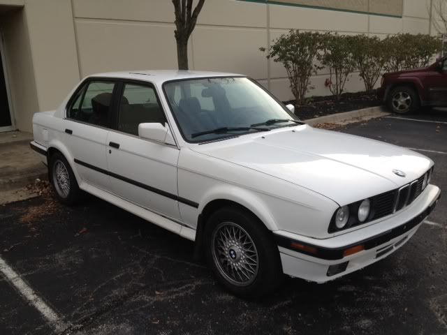

    Curious how rough this would be to do on the 89 ix I picked up about a month ago. Currently auto and I want it to be manual for future v8 swap reasons
    What all would I need besides tranny, pedal assembly....
    Yes Im new to BMWs so thats why Im asking.....

    5-speed transfer case too.

        I'm almost done with this and so far it has cost me
        325 for transmission
        425 for transfer case
        150 for fly wheel, all gear shift components including shift nob and transfer case cross member and the reverse cable
        50 for the clutch pedals and clutch cylinder
        503 for the clutch kit
        that's all you need for the swap but it can be real hard to find

            a good tranny isn't that hard to find. the transfer case is another story.
            how do you plan to do a v8 swap? what oil pan will you use? trans? bellhousing?

                  V8 swap? you may as well just leave it automatic, because you won't be able to use anything from a 325ix anyway.
                  if you're not keeping it AWD with a V8, just get a different E30.

                      like I said, if you're wanting to swap a V8, you can't even use any of the 325ix stuff anyway. a Turbo would make a lot more sense if you want to keep the AWD.
