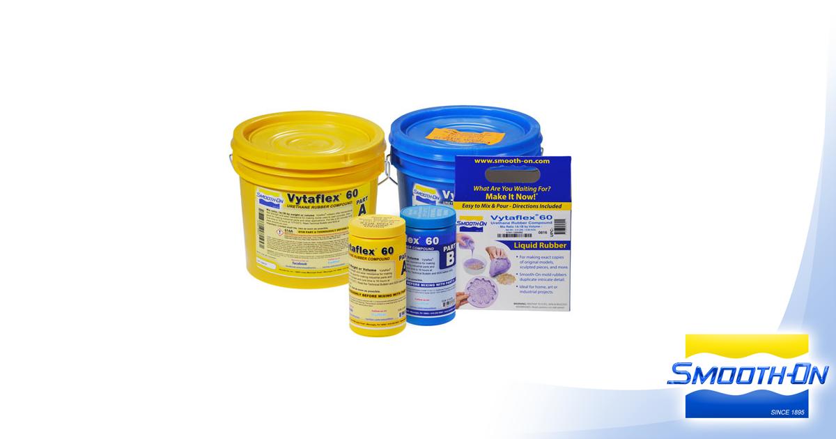

            #350
            It says the video is unavailable.
            For removing bubbles near the surface, use a heat gun or torch are sweep it across the surface. The heat will cause the bubbles to pop.
            Instead of using resin, why not use a castable rubber?
            Something like that, although intended for making a mold, would potentially work very well.

                #352
                Is it alright if I just ignore all 100 comments that are suggestions for removing bubbles? Yeah, I get it, if I had $20,000 worth of equipment or a $100,000 mold, I would make really nice parts. I'm just trying to get something that you bolt to the bottom of your car that stops mud from splashing up on to your car and looks pretty good from 2 feet away.
                Maybe I focused too much on the bubbles when I showed you guys pictures, but they are at most 1mm-2mm wide.
                Resin is just a generic term for chemicals that end up turning into polymers (read plastics) that you use to make things out of. @AndrewBird, you've given me the option of a urethane rubber (which is in the same class material as the thing I made the version 1 of the mudflap out of) with no UV resistance, about 1/3 the tensile strength, and the flexibility of a rubberband. It would just flap around in the wind and then eventually disintegrate unless you park it inside all the time. But, if you want, I can make a custom set with that material for you and you can test it out:). Actually, in all seriousness, I 100% would not mind, but I don't want to run that test myself on my own dollar. I would love to be proved wrong and these molds would work with that material no problem.
                I hope I'm not coming off as too impatient, but Jesus Christ guys. You've been waiting for something like this for years. The last set went for $700. Wouldn't you like a not-perfect one for $100? I am asking you guys questions not because I don't know what I'm doing, but because I want to get an idea of what you guys are expecting and I want you guys to have realistic expectations of what I am able to make in my garage with limited resources. I think I have enough info from you all. I'll re-update when I've made a few sets and finalize pricing. Then I'll ship some over to the guy who lent me the flap and he can give an independent review of them (if he's up for it).

                      #355
                      Chill man. You are taking helpful advice as criticism when everyone here wants to see this happen.
                      When you said resin, I thought of typical casting resins which are closer to plastic than rubber. You even said it was brittle when cold. You said the material you are using is 95A so I suggested a type of product that was 60A. I wasn't being specific, merely showing you there are other options. You said yourself you don't know what you are doing. I was leaving it up to you to find one that fits your needs.
                      You seemed worried about the bubbles so several people (including myself) gave some solutions. We are trying to help, not nit-pick your work.
                      P.S. - You can get a vacuum pump and small chamber off amazon for less than $300. Not exactly breaking the bank when you are considering selling these for several hundred.
                      https://www.amazon.com/Value-Gallon-...-2-spons&psc=1
                      Keep up the good work!
