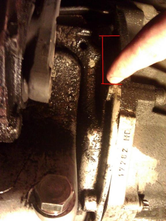

    This is where things get tricky. Before I lubed up the splines and got messy, I decided to fit the driveshaft with new components to test fit. As others before me have pointed out, there is a flange on the back of the bell housing for a torx bolt that definitely gets in the way of the bolt heads that secure the guibo to the centering pin/driveshaft (the 50mm bolts.) In my estimation it was 1/8” of clearance trouble, as I point to.
    There are really only two options here – 1) grind the flange back, or 2) grind the bolt heads. I opted for #2 for a couple of reasons. One was out of necessity. I only had a 4” grinder and I couldn’t quite fit it where I needed to with the differential in the way (pictured below.) This is removable, but I didn’t want to fuck with it. Two, I just really didn’t want to be grinding on my oil pan. Period. Personal preference.

              It's going to take a good deal of grinding on the cover plate is all. It's certainly doable, but you're gonna find yourself at a weird angle working over your head for a while. Just an fyi -- I found that the area above the torx bolt flange also gets in the way (area shown below.) So not only do you have to grind the flange back ~1/8", you're also gonna be grinding the area above it. My bolt heads were getting stuck in that highlighted area as well.

                          the lower bellhousing really doesn't support the engine/trans either so there's not really any risk in grinding that down.
