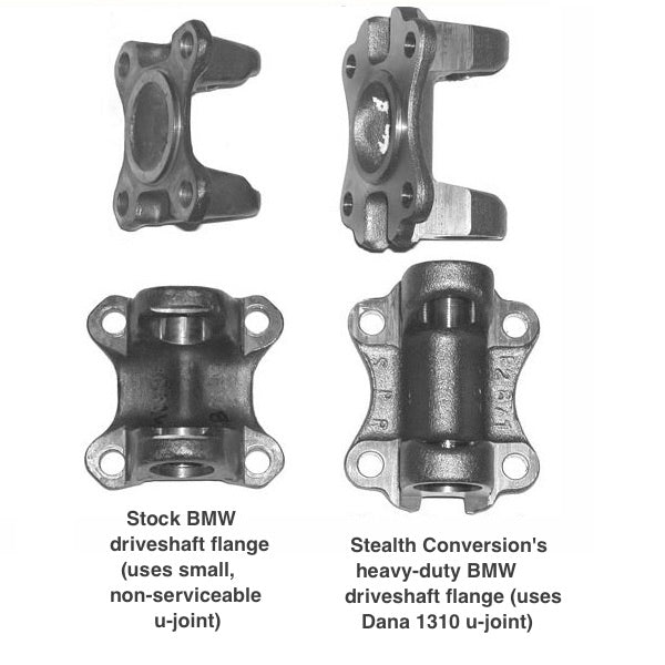

4.c. Driveshaft
The stock E30 front drive shaft is a one-piece unit using a guibo at the front end. It is not jointed and goes straight from the T-case front output splines to the diff input flange. The E34 and E53 front driveshafts are similar.
The E46 front driveshaft has two u-joints. These are required because the transfer case front output is not aligned with the differential input flange.
No BMW driveshaft u-joints are rebuildable.
A front driveshaft must include some plunge. The engine block, aluminum transmission case and aluminum transfer case will expand as they start from cold and come up to operating temperature. The driveshaft will not have the same change in length due to temperature change. To prevent excess loads on the cases, shaft and bearings, the front driveshaft should be able to accomodate the change in length. The stock E30 and E53 driveshafts do this via the guibo and by the fact that they are not rigidly retained in the T-case.
The BMW 4 bolt differential flange is common to rear and front differentials. The 4 bolt flange at the rear of the stock E30 iX rear driveshaft will mate to the input flange on an E46 front differential.
This means that an adapter yoke produced by Jags That Run can be used to build a front or rear driveshaft using domestic 1310 series universal joints, which are readily available.
This yoke could be used at the differential end of either front or rear driveshaft to serve as the basis for a custom shaft.
