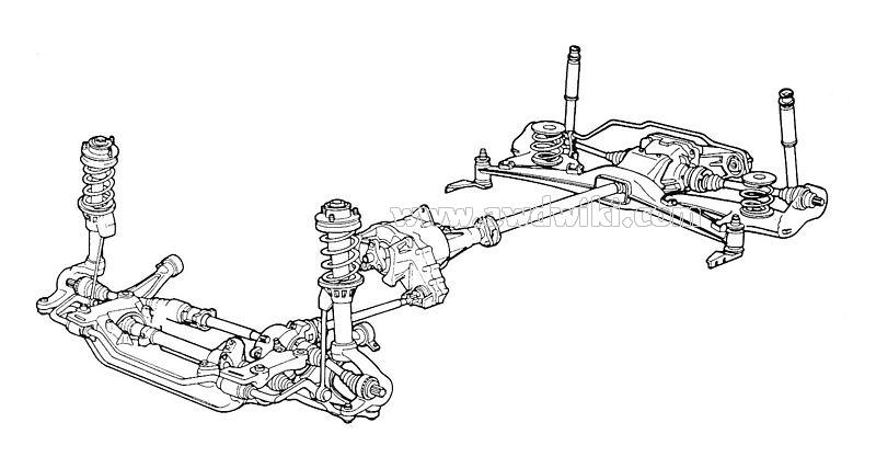

              This should help
              That transfer case is a bitch to work around, heres a diagram to help you see what your working with. You might be able to get around it with a pipe bender or a extension piece. Good luck, I'll be doing this in the future sometime.

                Dont know if that image was attached on last post so here it is again
