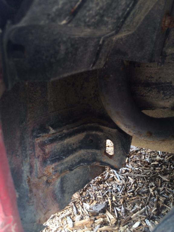

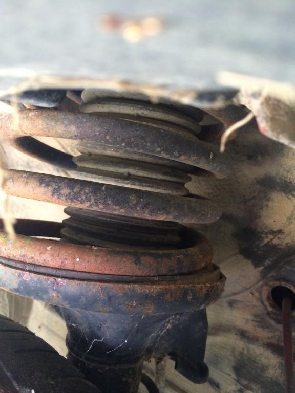

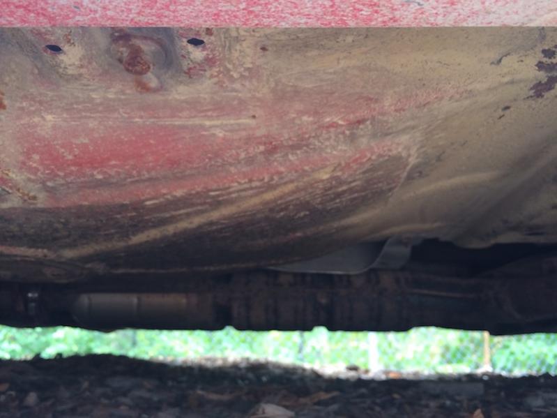

        For the price, I am now in this car about $6,000.. I just went and took a few pics, the rust is probably in between bad and horrible, maybe I am over reacting but it is mostly rust on the under side of the car.
        I have driven the car probably 10-15 miles and the transmission and engine feel solid, there was no slipping, and other than the exhaust issue the engine feels strong, it does only have 100K original miles.
        Here are the pics:

                Just saw the pics. Thats not very rusty at all!

                  You're a Cali guy like me, and we're not used to rust. It's bad, but truthfully, not the end of the world. Buy an angle grinder and a wire brush and go at at, it'll probably clean up nicely, for the most part. Mine was rusty too (PO parked it 1 block next to the ocean for 2 years) but I took apart most of it and derusted it, and since I'm in CA, I'm not too worried about it coming back. The shock mounts, I'm not so sure about...good luck with that:D.
                  • The Dark Side of Will
                    • Jun 2010
                    • 2796
                    Are there any holes in the body? Any places you can stick your finger or a screwdriver through something that's supposed to be structural?
                    If not, wire brush and paint!
                    If the pics show the worst of it, that car's solid.
                    The strut housing looks bad, but that can be replaced with a wrench... the same with the rear subframe, but it's just a little more of a PITA.

                          Wow, I guess its not the end of the world..
                          What treatment do you guys recommend for this? I know it won't ever be perfect but I would like to try to treat it..
                          • Northern
                            I like cupcakes & sh!tboxes
                            • 5264
                            sandblast or wirewheel/sand until all traces of corrosion/pitting are gone
                            clean with a solvent such as Acetone
                            epoxy prime (or use regular primer alternatively)
                            paint
                            re-undercoat with new schutz or alternative.
                            It always helps to spray on a Corrosion Inhibiting Compound of some kind from time to time as well, like Fluid film or LPS 3
