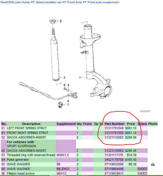

            FYI there is an online BMW parts catalog with diagrams/part numbers and close prices at RealOEM.com
            example go to home page and enter last 7 of VIN in search for full part catalog for your car (this is the IX struts)
                  Thanks a lot man, I really needed to see a chart like this one. This def gives me a better idea of the things I need and the $$$ I'll be spending.
