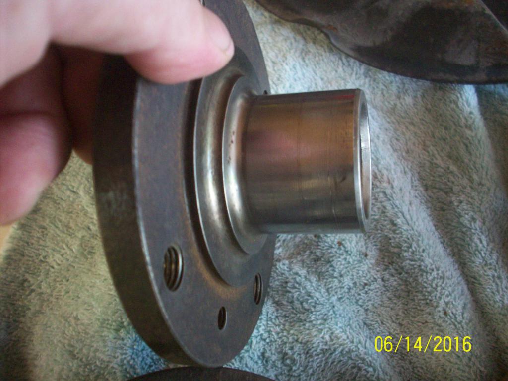

          I ordered a new hub from Steve Blunt. www.blunttech.com he's good friends with Jake. FAG bearings. Make sure you install them correctly. The first time I installed the bearing by myself I ruined it. I pressed it into the strut by the outer race (correct way) but then I pressed the hub into the bearing while supporting the strut (incorrect way.) You need to support the inner race from the back side when you press the hub in or you'll damage the bearing because you're literally pulling it apart. So..
          1. Support the strut and press the bearing into the strut via the outer race
          2. Support the inner race and press the hub into the bearing.

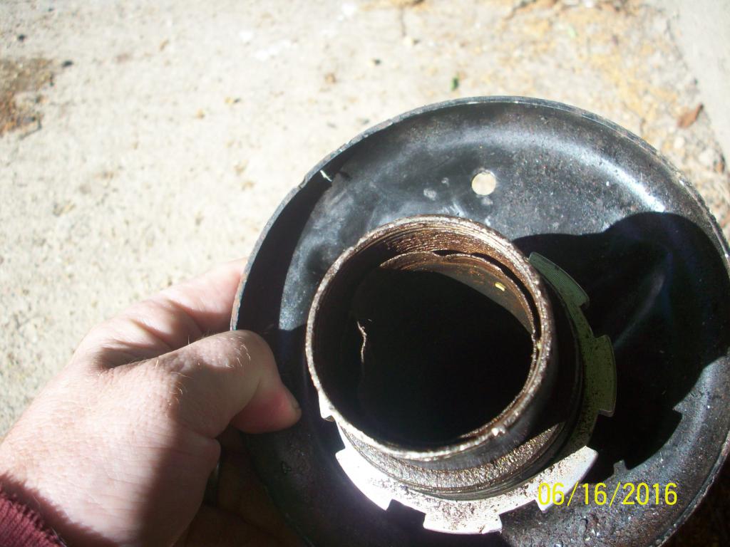

            I worked on trying to get the inner strut out for half a day...
            I pulled the guts out and the outer shell of the strut insert is seized in the strut assembly... I pried and pulled and well gave up..

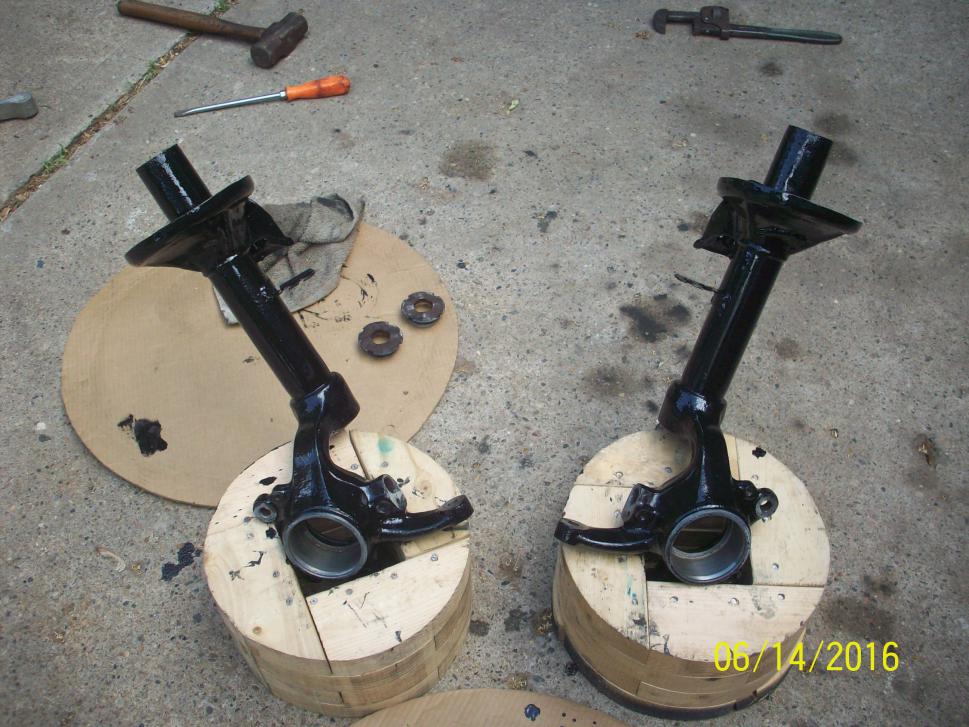

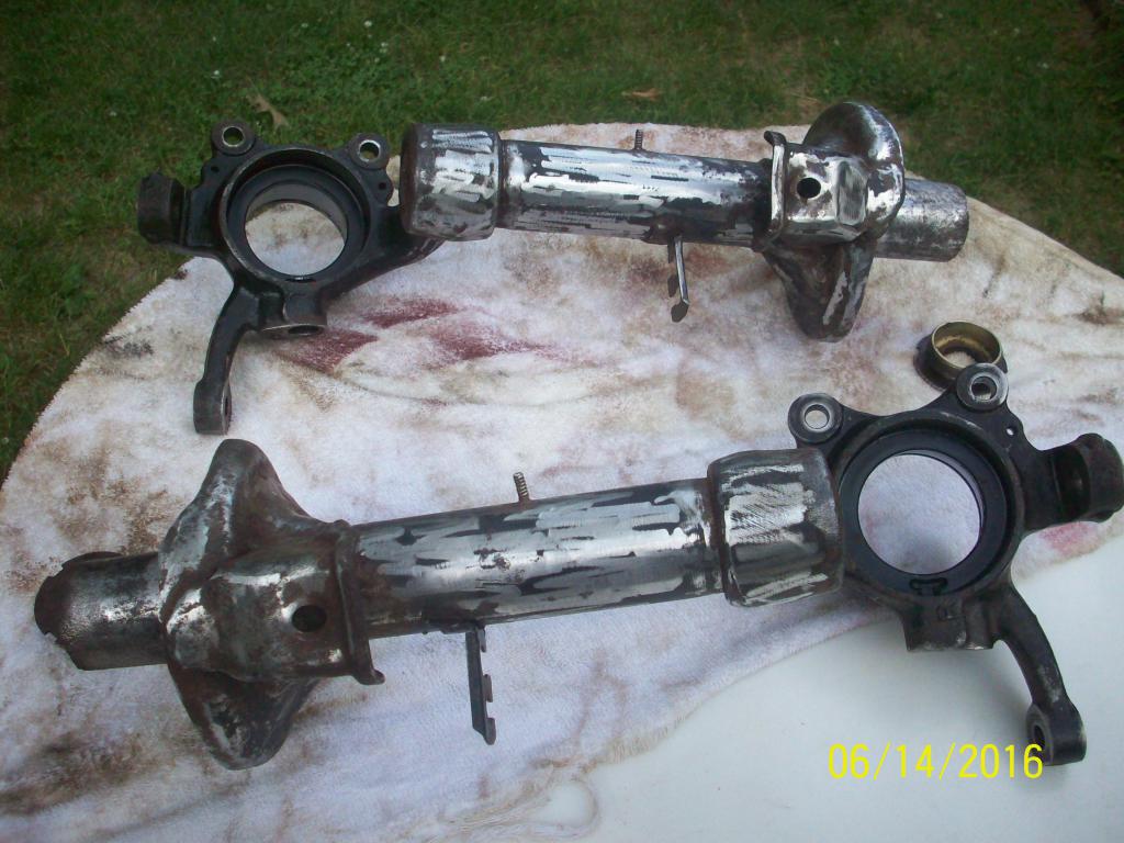

              Ordered a real rusty pair of struts from Classicdaily (like I said before) - super fast shipping, easy guy to talk to - but damn they were rusty - spent 5 hours cleaning, sanding, and prepping for POR-15 treatment.
              • 95BMWIC
                • Apr 2012
                • 353
                I used the degreaser, and the metal prep and laid down 2 thin coats of POR 15..

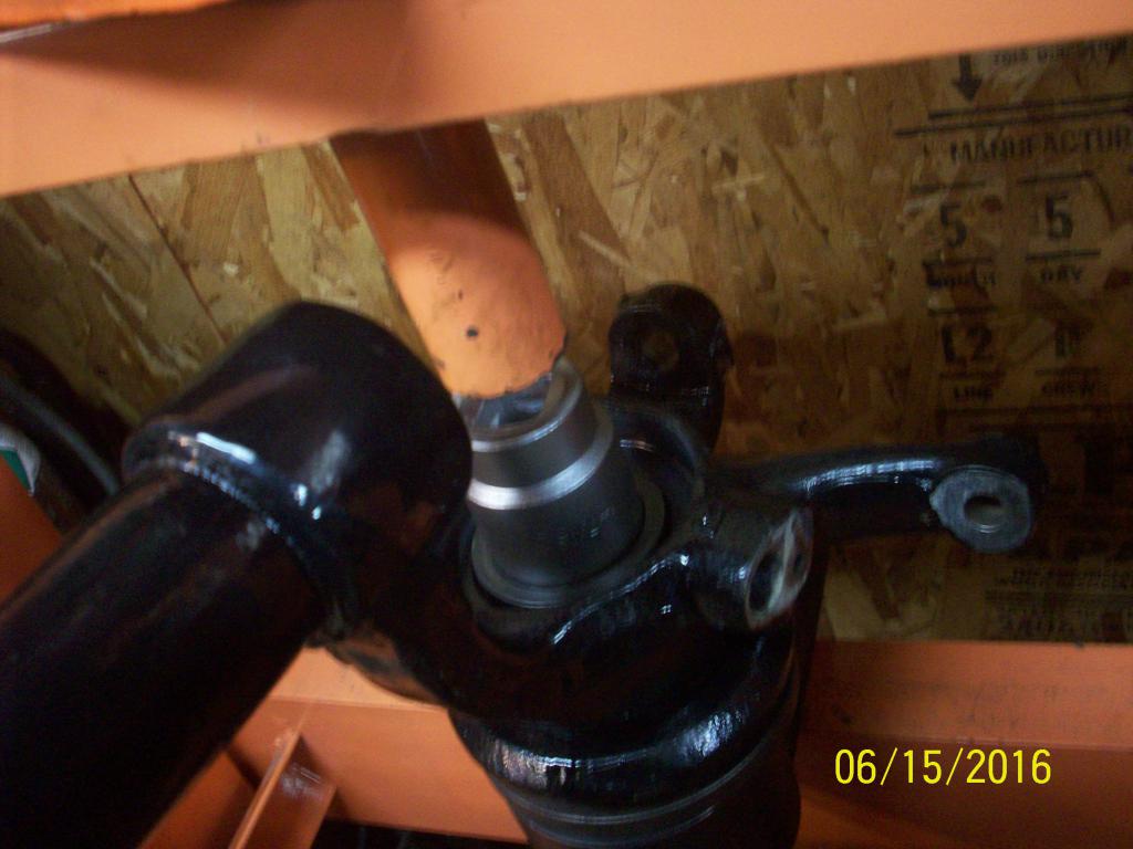

                  I wish I would have read this first, because when pressing in the hub, I struggled to get it fully in.. I have a 20 ton press (Harbor Freight) after getting the bearing in, I could wiggle the hub...
                  I called a friend, and he stated I needed to support the inner race - so I found a right sized socket and when I pressed it, it moved the extra mm and it seated.. apparently it was flexing - when pressing the final "stretch" without supporting the inner race..
                  I dont think I damaged it - but we will see.. (and I should have known better)..

                    One thing that made life a lot easier, was that I threw the new FAG bearings into the freezer for a day and let the strut assemblies sit outside in 95 degree heat.. It was very easy to get the bearing started and the hub assembly to start..
                    Didn't need to order a hub after all - the rusty struts each had a hub - so after some dremel cutting - I was able to remove the inner race from each of the hubs..
