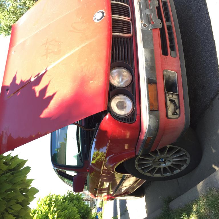

                      Red one is the ix. I got it for $600 in non-operating condition with a clean title. The previous owner was an older lady and she had it for 16 years. I've got it running, the problem was a bad battery and old old gas. It's auto, sadly, but I want to turn it into a winter beater/rally car. Or sell it on so I can invest in turbo parts for my cirrus sedan

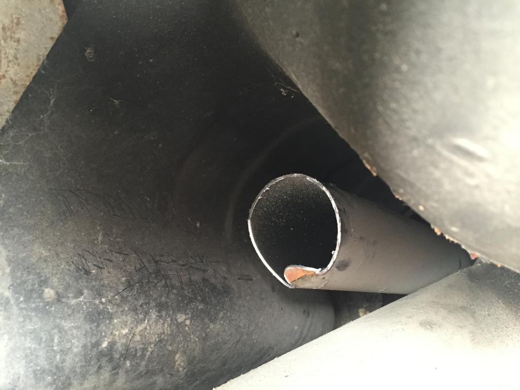

                          Previous owner chopped the drive shaft about a foot before the diff. Anyone know where to get a new shaft, or is this damage repairable in anyway?

                          • wodcutr
                            • Apr 2009
                            • 2193
                            I have a rear ix drive shaft and I think it has your name on it! I live in Heber so not too far away.

                            • nando
                              • 34844
                              Wow what the hell. That had to make some noise...
