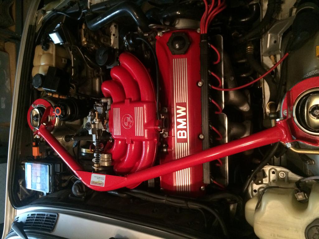

                  I did not ruin any threads. I kept trying and ended up tightening the inner ball joint with a impact and loosening it to torque it. Thanks for the advice everyone. I'm about to get her back on the road tommorow. Anyway is the axle nut torque 149 Ft Lbs? 200 NM? And is the axle nut torque the same on all corners? Im going to have to get a cheater bar and a 30mm 6 point because 12 point keeps slipping. Here's a picture of my engine bay now that it's together. I like red..
