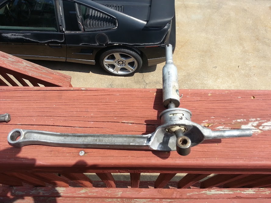

    Repaired E30 shift support rod above with E34 rod below:
    Z3 1.9 shifter installed. I'm waiting until the new Z3 1.9 shifter for my dad's E24 and the new transmission rod joint(s) arrives in order to measure them for making my own semi-weighted DSSR.
