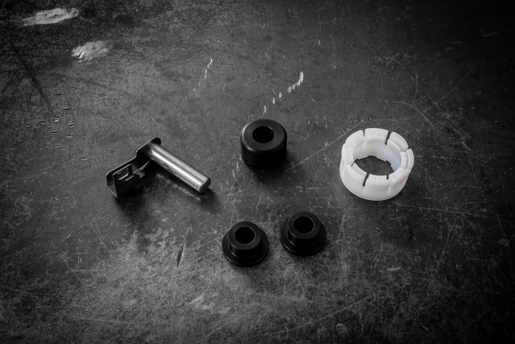

                      It's all the same except the shifter arm bearing.
                      This guy. Don't bother buying a new one. They are expensive and wobbly. Take your old one, cut out the old bushing. Replace it with anything you can find. I used a swaybar endlink bushing from an Explorer I had laying around. Garagistic makes a delrin replacement as well. It's the red circle.
                      E30 DELRIN ROUND SHIFTER BUSHING KIT This is our complete E30 Delrin shifter bushing rebuild kit. Pairs great with our Supreme Shifter found here. Our Garagistic Delrin rear carrier bushing replaces the original rubber bushing found inside 25111220707 (which not only had lots of "give" but is usually neglected and

                        so i found out that with blown engine mounts, the engine moved forward and back and caused some weird binding when the delrin got hot in the carrier. it made an awful sound and feel. When everything was cool/cold it never did it. I swapped it out for the garagistic poly bushing and havent had a problem since. I also did engine mounts so who knows. just my experience.
