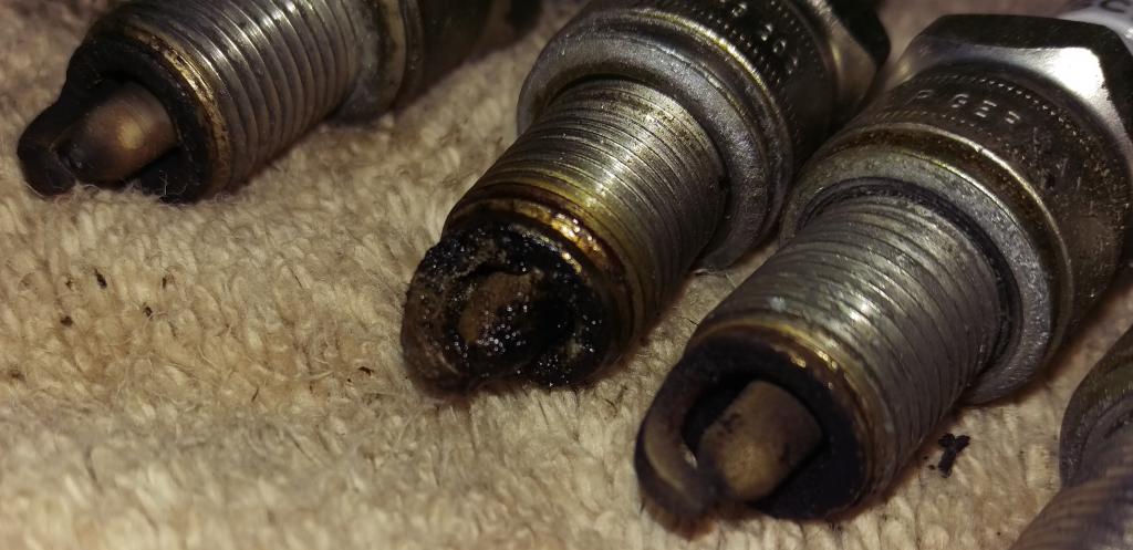

I pulled the plugs and found that #5 was fouled up.. as you see in the pic the others weren't fouled and were all in similar shape.
So what can cause this?
