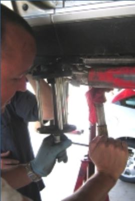

      There's the easy way and the hard way to replace the rear subframe bushings.
      With the correct tool, its not even an hour job, without its a matter of either dropping the whole subframe or fiddling with a makeshift tool.
      Unfortunately the "correct" tool is a Genuine BMW tool. There was a guy in Canada making his own version a few years ago, but he no longer makes them.
      That's why in this case, the dealer might be coming in substantially less expensive.
      If someone who works at BMW could provide an ETK of BMW genuine tools with associated part numbers, they would be the real MVP.
